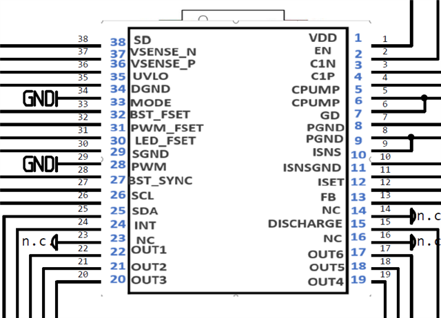

Can you please help review the LP8866S-Q1 and calculation tool below? Thanks

Hi, Xiaowei
Sure, I will review it and give you a feedback late.
Hi, Xiaowei
Pls kindly let customer to add the device component on the schematic and then we can help to do the review. It is hard to review without correct connect for the external component and the device.
Hi, Xiaowei
What I mean is pls kindly share the correct connection of the LED pin map schematic again and share with us first.
Hi Zhiqian
Customer feedback currently they have no resource to add this device to their IC library.
Can you please review the updated SCH base on the pin number? Thanks
Xiaowei Zhang
Hi, Xiaowei
I reviewed the schematic this time, for the next time, pls let customer do the whole lib and schematic first. It is hard to checking with mismatch wire connect for different pin.
