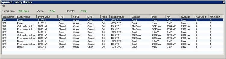

Is there a document that describes the Safety History event values?
I have some reset events with event value 21 and a couple with event value 11.  Any info would be greatly appreciated.

  • Patrick,
    The Event Value in the Safety History provides post reset status information. An 11 indicates normal operation after a power on reset and a 21 indicates normal operation after an external reset has occurred.
    Tom
  • Thanks Tom,
    Do you have a list of event codes?  I have another code, reset code 41.
    Patrick
  • Patrick,
    I tracked down the decoder ring for the Event History.
    The most significant digit gives the source of the last reset.  The least significant digit gives the current operational state.  In this case (41) the code indicates normal operation after a watchdog reset.

  • Thanks Tom,
    This helps but brings up another question of why the precharge condition caused the watchdog reset.
    Patrick
  • Patrick,
    Were there any faults noted in the Safety History or in bqWizard? The Watchdog monitors communications with the host and can issue a reset if communications is interrupted for more than the Host Watchdog Timeout setting. The Watchdog monitor can be disabled by setting it to "0".
    Tom
  • Tom,
    Yes there are some faults in the Safety History:
    I was testing the precharge behaviour when this occurred and the log file contents are concerning.  The cell under voltage threshold is 2900mV and cell under voltage recovery is 3100mV.  I was expecting to see <100mA charge current in this condition but the currents in the Safety History log appear to be normal charge current levels (~2000mA)  I have monitored the charge current previously during precharge conditions and it was below 100mA.  The CHG and PRECHG FETs appear to be responding properly and consistent with BQWizard.

  • Patrick,
    The current should be the pre-charge current set by you current limiting resistor when in pre-charge mode. Could you send me you .ppcsv and a log file that covers when the event occurs? I will try to help you diagnose the problem. A schematic may be helpful as well.
