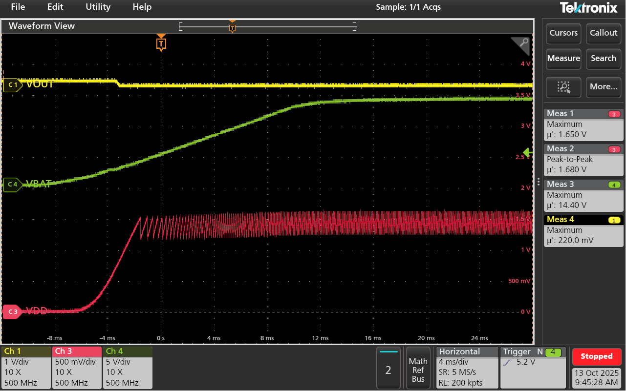

My customer now test TPS3840DL30DBVRQ1 on their own PCB.
Could you check the schematic below first?
While testing they found that the waveform below.
(Green:BATT_IN, Red:VDD(P2), Yellow:\RESET(P1))
As you see IC cannot detect VBATT_IN rising signal properly.
And my customer have 2 solutions to solve this problem.
1.Change C2876 from 10nF to 100nF
or
2.Change R7325,R7326 to lower value maintaing same resistor ratio
Anyway my question is, these 2 solutions are valid for fixing this problem.
And one more thing. Could you check the minimum operating current for startup TPS3840DL30DBVRQ1?
I am asking it because I found that supply current into VDD pin is maximum 700nA, but they found that they had to apply minimum 1mA current by adjusting resistor divider(R7325,R7326).
