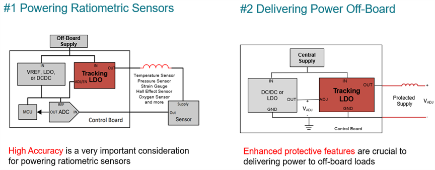

  1. What are some common applications of tracking LDOs?
Tracking LDOs are used in two types of applications most commonly: where high accuracy of output voltage is prioritized (eg. In powering ratiometric sensors) and where enhanced protective features are required to protect the main power distribution board while powering off-board loads.
In the former application, a tracking LDO helps maintain a tight tolerance between VCC (input voltage of the sensor i.e. Vout of the LDO) and VREF (reference voltage of the LDO which also powers the ADC in the MCU receiving inputs from the sensor) while also protecting the control PCB from faults on the cables. This way, the fidelity of ratiometric sensor measurements is maintained.
In the second application, long cables are used to supply power to off-board loads from a control PCB. The long cables are susceptible to failure. Wear and tear and degradation of insulation can cause the LDO output voltage to short to the battery voltage or to ground. These long cables also have significantly large inductance and this can cause inductive kickback during a power off sequence which can cause a negative voltage to appear momentarily on the output of the LDO. Integrated protective features protect the LDO and thus, the main control PCB from any faults on the cables. The LDO thus acts as a buffer.
