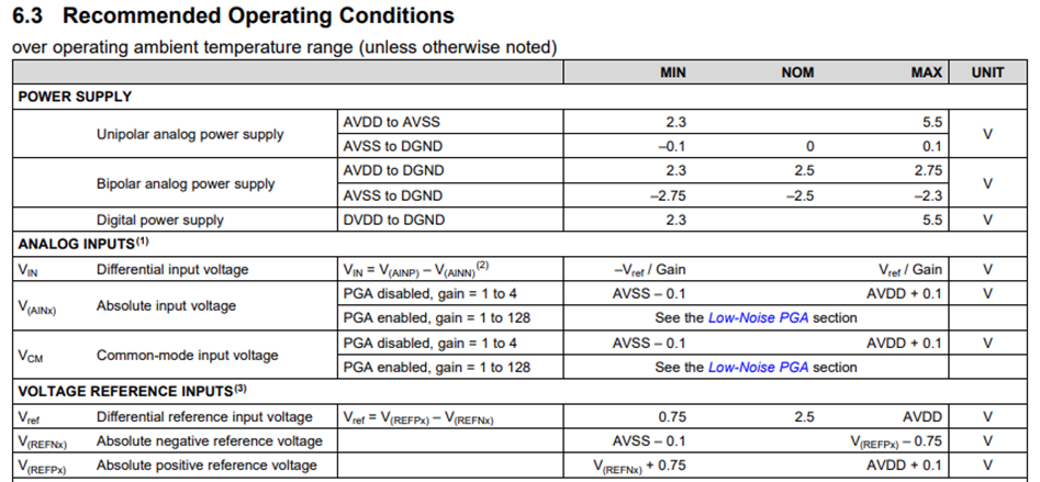

Question 2
Operating Conditions:
Using in single-ended mode
VADD = 5V, VASS = 0V, Vref = REFP0 = 4.096V, REFN0 = AVSS = 0V
Question:
If -0.1V is applied to AINx, what will be the output code? Will it be 0000h, or a code corresponding to -0.1V?

    Question 2:
    The expected code would be the twos compliment of -100mV since the data format is bipolar.
