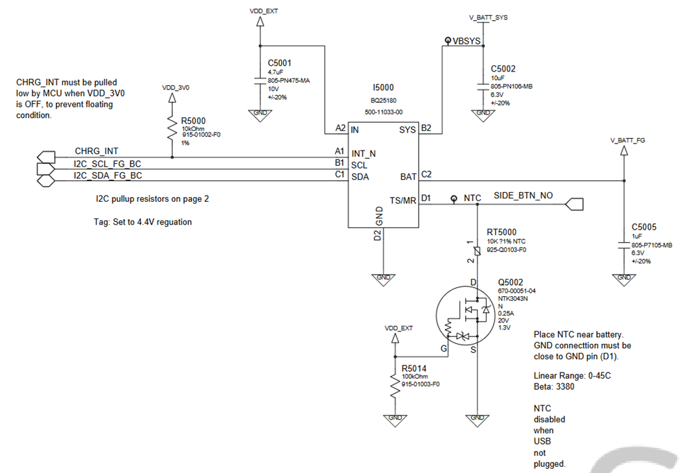

Hi Team,
We use the BQ25180 and we find there are two different C2 pin voltage if we used USB to power up. (We didn't connect the battery) Some are 4V and some are 2V. We need 4V to release the battery with PCM lock.
  1. If we plug in the battery and plug off the battery on the board which C2 is 2V. C2 will become 4V
  2. The board which C2 is 2V, its Vout is affected by USB V_EXT
According to the flow chart from datasheet, BATFET should be disabled if VBAT = 0, but it has conflict that we saw. May you help check why we saw 2V in some boards?
Roy

  • Hi Roy,
    Two quick checks to separate the two cases:
    1. Is charge enabled via I2C on all boards when VIN is applied and the battery is not connected?
    2. Please share scope captures for both cases (C2 pin = 2V and 4V): VBAT, VIN, and VSYS as close as possible to the IC pins.
    With VIN present, charge enabled, and no battery, VBAT behaves as shown in Figure 9-2 of the BQ25180 datasheet:
    CBAT charges up to VBATREG --> Charge terminates and the BATFET is turned off --> CBAT begins to deplete --> VBAT falls below the recharge threshold (VRCH) --> New charge cycle begins --> Cycle repeats
    The captures will confirm whether this is the behavior when the C2 pin is 4V.
    Alec
  • Hi Alec,
    The symptom seems to relate the capacitor used on the fuel gauge BQ27427‘s LDO output VDD pin. Here’s the schematic:
    The charger measurement of :
     1. Remove BQ27427 and keep BQ25180 C2 pin capacitor=1uF
    2. Remove BQ27427 and keep BQ25180 C2 pin capacitor=1+4.7uF
    3. With BQ27427 VDD capacitor =2.2uF
    4. With BQ27427 VDD capacitor =4.7uF(Current design)
    BQ27427 uses VDD pin capacitor =4.7uF for solving the BQ27427 unexpectedly enter sleep mode issue.
    The measurement result 1. and 2. Seems to be as expected. But with BQ27427 LDO connected, the “CBAT charges up to VBATREG --> Charge terminates and the BATFET is turned off --> CBAT begins to deplete --> VBAT falls below the recharge threshold (VRCH)” cycle disappears(measurement result 3. and 4.).
    Also when BQ27427 uses VDD pin capacitor =4.7uF, the load effect of LDO output seems to be the root cause of this issue? Pleas provide your thoughts.
    Not sure if you could  provide the module spice of both side BQ25180’s charger block and BQ27427’s internal LDO block for simulation this symptom?
    Roy
  • Hello Roy,
    It looks like there is some interaction between the charger and the gauge which may be causing this behavior. I would recommend keeping the nominal capacitance and rating for the LDO for the gauge, it is very important for low power modes to maintain low IQ. Unfortunately we don't have any spice models for the chargers or gauges.
    Can you clarify that the captures #3 and #4 are both without a battery? Can you share a zoomed-in version of #4 so we can look at the waveform of VBFG oscillating?
    Sincerely,
    Wyatt Keller
  • Hi Wyatt,
    The experiment result 1,2,3 and 4 are all without battery.
    Here’s the Zoom in waveform of 4. Could you please help to provide more insights about the interaction between the charger and the gauge? We have another product using the other vendor’s charger with BQ27427 and did not see this symptom.
    Roy
  • Hello Roy,
    Do you happen to have the datasheet for the other charger device?
    I think what may be happening is the gauge is turning on and consuming all 8mA of our IBATSC current when using the large capacitor for VDD, the loading may not be consistent for the gauge either since it is a MCU.
    It looks like VSYS is supplied and stable, is their host active? This can also disable charge while there is no battery present to prevent any oscillations. I would also be curious if they have the register dump from our charger while this behavior is occurring?
    Sincerely,
    Wyatt Keller
