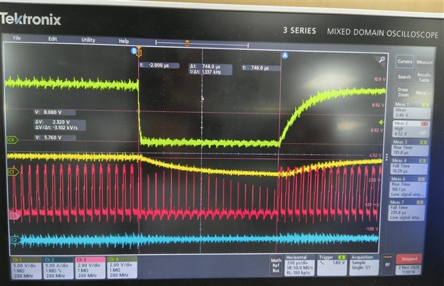

Hi, experts
We're developing an industrial UPS that consists of a AC-DC Rectifier, DC-AC Inverter (2-level) and a DC-DC Chopper. In all of these modules, we use the TI UCC21750-Q1 Gate-Driver IC to drive SiC MOSFETs (4 SiC MOSFETs in parallel).
While we were testing the Inverter board ... we observe the Gate-Driver FLT pin is pulled down to low when DC Link voltage goes above 250 VDC even if the DESAT voltage is not reaching 9.15V (DESAT threshold voltage).
Another instance we observed the FLT pin going low is when we short the DESAT pin to COM which is not supposed to happen.
We're looking for possible solutions to these as soon as possible.
