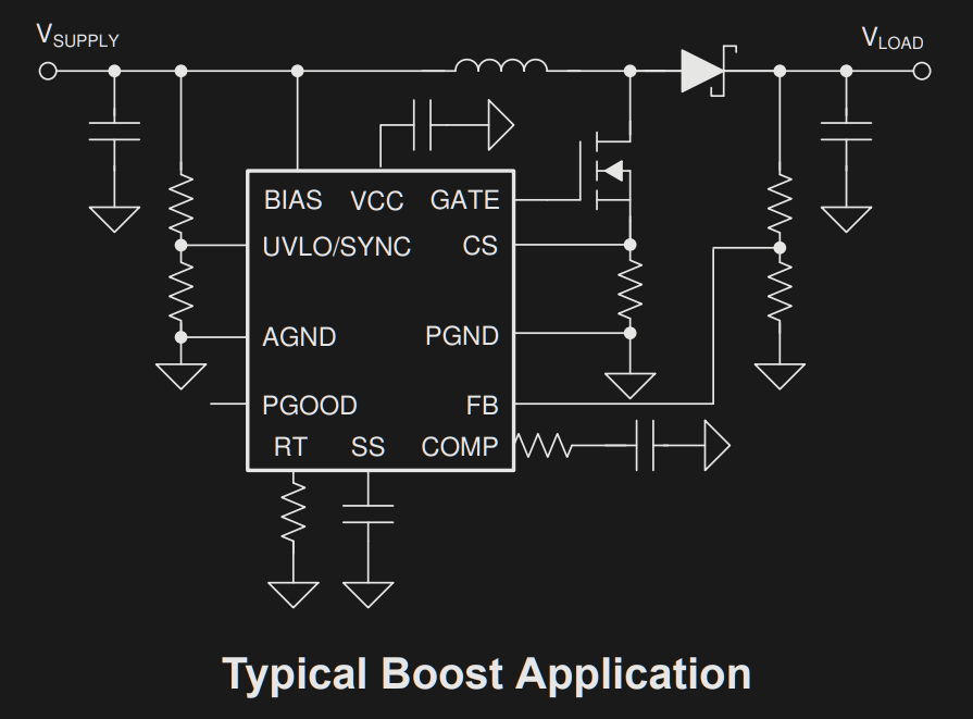

Part Number: LM5155
The datasheet of this part says:
It can operate with the input supply voltage as low as 1.5 V if the BIAS pin is greater than 3.5 V.
In the schematic, i can see BIAS. But i can't see "input". Where is input?

Hi Johny,
The input supply voltage is Vsupply.
The bias pin is the supply of the IC.
If the IC is supplied by 3.5V, the input for the boost stage can go down to 1.5V.
The bias pin does not have to be connected to the Vsupply, it can also be connected to an external voltage source.
Best regards
Moritz
Hi Johny,
Please refer to below. Vsupply (IN Boost) is the voltage that is going to be boosted.
Vbias supplies the IC. It has to be at least 3.5V. If it is supplied from external, Vsupply can go lower.
Best regards
Moritz
