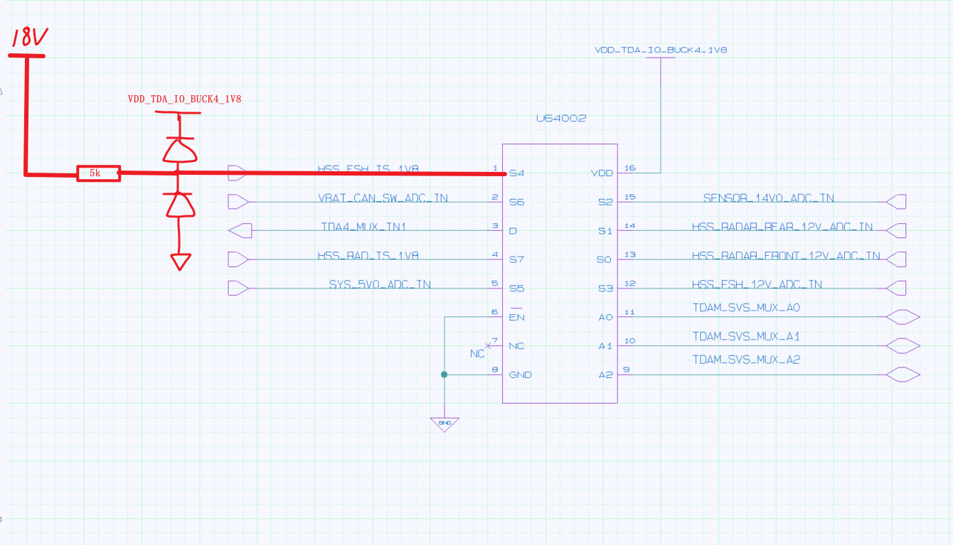

Use 1V8 supplied the TMUX1308-Q1.
If ADC channel input voltage over 1.8V(like 18V, not last long ), do i need add some protection parts ?
solution1: No need, connect directly
solution2: add resistor in series to limit the current and dual diode to clamp to voltage below (1.8+Vdiode)V, like picture.
Or other suggestion?
