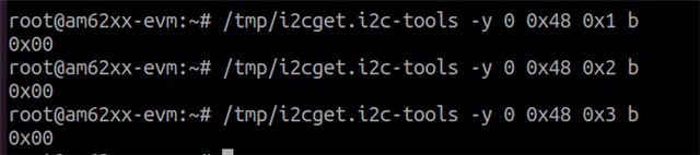

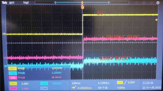

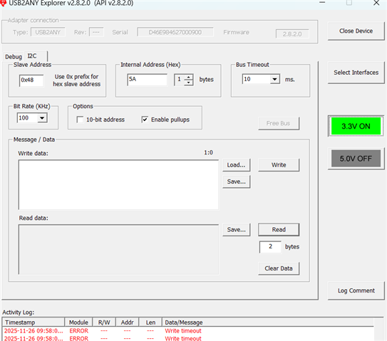

Dear expert TPS65223Q1 normal works from room temperature to high temperature 85C,but when the ower is turned off and then power on at same high temperature 85C  the PMIC has no output,meanwhile VIN and enable is normally  could you figure or guide where the root cause is
