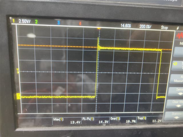

    - There is mild ringing in the switching node of 2V in the switching node when lightly loaded. I think this is normal and acceptable?

    The SW node ring is normal, but the height of the ring is likely due to the large SW node trace or suboptimal measurement techniques. I would recommend utilizing either a differential probe or the tip and barrel method to accurately get a SW node waveform measurement.
