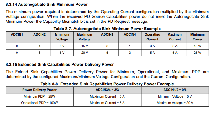

Question in title, I believe the device defaults to 5V @ 500mA, if unable to meet minimum voltage/ current /power operating value?
Overall, my goal is to request as much power as possible. If I am unable to source 20V @ 3A , request the next largest PDO. Curious if this is default behavior

    The TPS25730 will request the maximum power available from the Source within the acceptable range set by ADCINx and assert the capability mismatch bit.
    It will not default to 5V/500mA.
    Aya Khedr

  • Hi Cameron,
    TPS25730 will only request the maximum power the source is able to provide. For example, if TPS25730 is configured to have maximum voltage/current of 20V/5A and the source only has PDO capability of up to 15V/3A, then TPS25730 will only request 15V/3A in this scenario and assert the capability mismatch bit in its Request message to indicate the sink system (TPS25730) requires more power.
    The sink (TPS25730) will never request more than what the source is able to provide. Let us know if you have any further questions or concerns!

  • Hi Cameron,
    The Source offers its capabilities first, and the sink requests from the PDOs offered by the Source. Hence, it will never request 20V/5A if the Source is not offering that power level.
    See attached PD logs for example. In the attached logs, the Source is 30W capable (20V/1.5A max) and the TPS25730 is configured as 20V min, 20V max, 5A operating and 5A maximum current.
    Also, please check out the TI-PD-Analyzer Tool used to monitor and log PD communication data.
