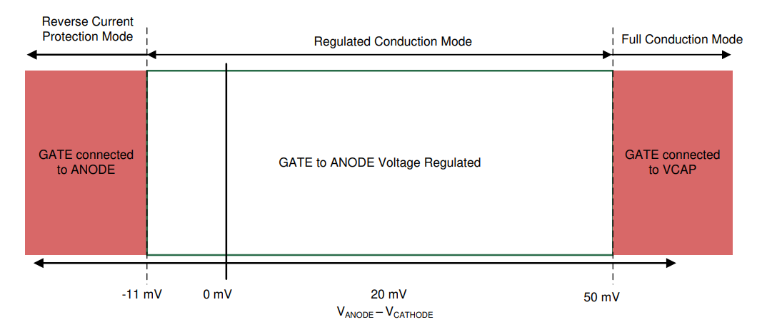

Hi team,
Could you please share your comments for below questions?

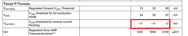

  1. In Reverse Current Protection Mode, is it possible to achieve zero reverse current? And the MAX reverse current is -11mV/Rdson.
  2. However, in the Regulated Conduction Mode, there may be a certain amount of reverse current, right?
