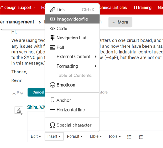

    We are using two of these DCR010505 converters on one circuit board, and the product has been going to customers since 2010. We have not had any issues with field returns until about 2024 and now there have been a rash of field returns since 2024. We notice that one or both converters run very hot (about 110°C) and fail. The application is industrial control used at < 85°C. Last year we changed the MOSFET (Q63) that is attached to the SYNC pin to a lower capacitance device (~4pF), but these are not out in the field yet.I can provide circuit diagram but can't seem to paste it in this message.\

    Please upload schematic using Insert tab.
