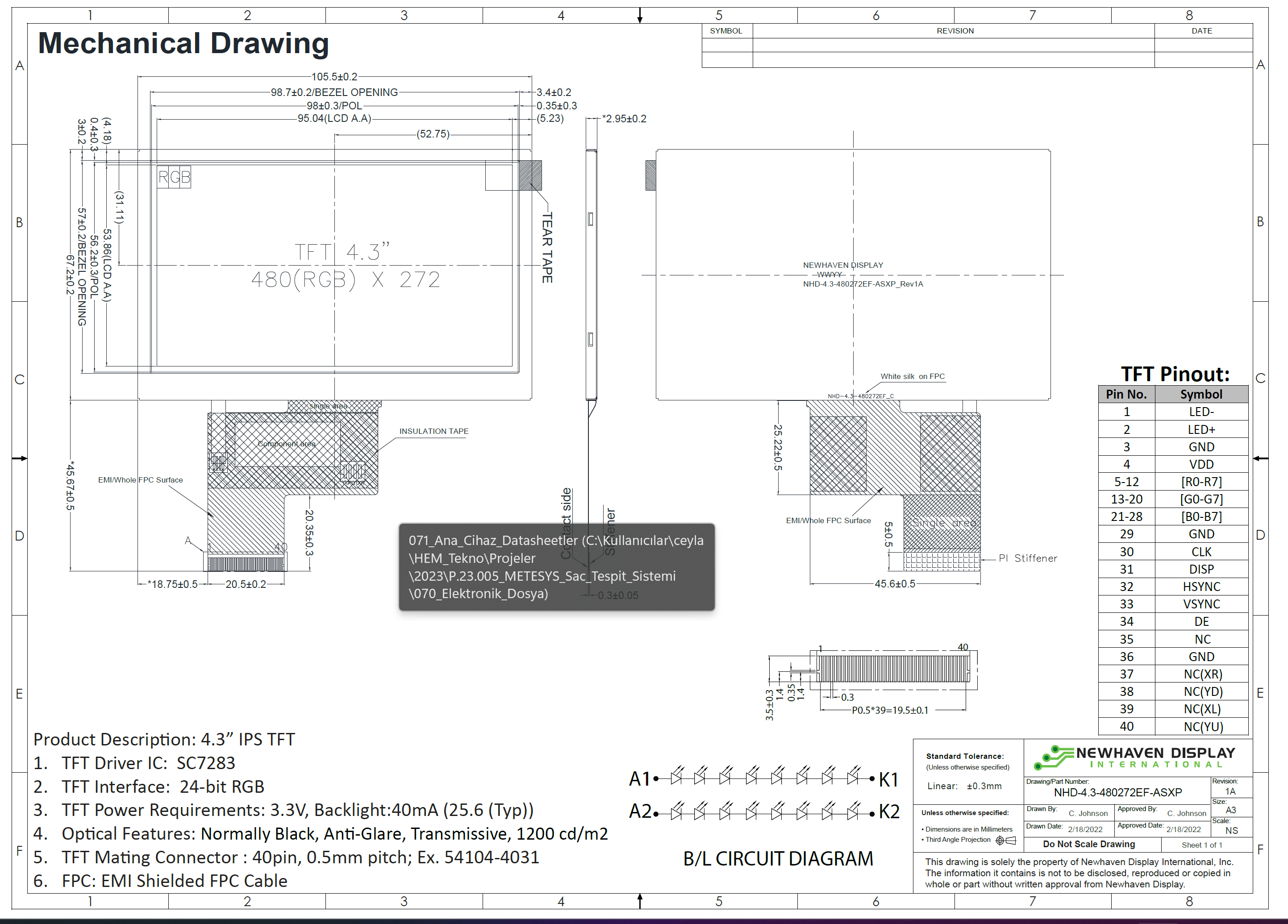

The TPS61161A LED controller we added to our circuit for use in our project doesn't work. Do we have to apply PWM to the CTRL pin? It doesn't work with just ON/OFF?
Our screen backlight is a 10-LED, 2-series LED.
Could you please check the TPS61161A and screen circuits we added and help us?
