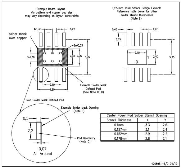

It seems TPS7B8633QDDARQ1 has two types of land patterns, DDA and DDA0008B. Which one is the correct land pattern?
DDA
DDA0008B

Hey Shunsuke-San
We have recently updated the datasheet, if you look at the online datasheet now you should see only one DDA package drawing DDA0008B-C01.
Let me know if this helps.

Hi Su-san,
We still can see the two patterns of the package on the online datasheet.
Which one is the correct?
Shunsuke Yamamoto
Hey Shunsuke-San
The datasheet on ti.com only has one drawing now:
The reason there were two package drawings was because this device was planned for two different A/T sites and used different lead frame numbers which are linked to different package drawings. The new package drawing in the datasheet now is a consolidated version so please use the land pattern in the updated version.

Hi Su-san,
Thank you for updating the datasheet just now. I have finally seen the updated datasheet!
