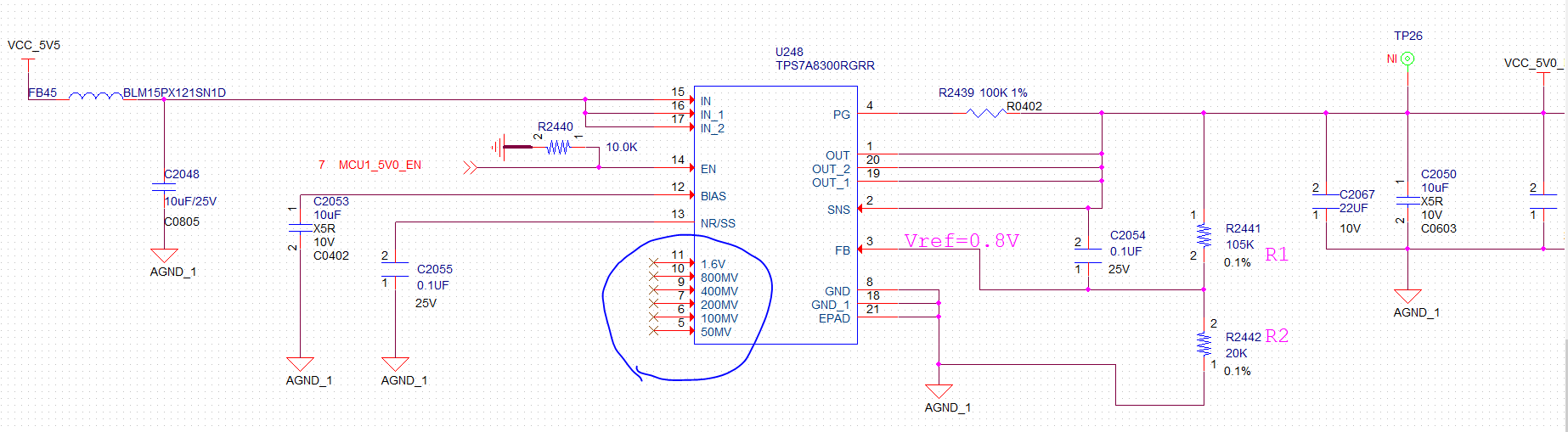

TPS7A8300: How to handle pin of ANY-OUT Programmable Output Voltage when I use adjustable operation through external resistors?
Part Number: TPS7A8300
I want to use adjustable operation through external resistors to output 5V. As below figure shown,  I use R1=105K and R2=20K as external resistors to get 5V  power. My queation is how could i hande  pin of ANY-OUT Programmable Output Voltage which are not used?  Directly open like below figure shown?
Thanks in advance!
Best regards!
