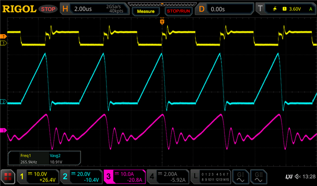

    The circuit is working much better now, there is no apparent instability, so the calc tool seems to have worked ok.However, the main FET switch is getting too hot. I didn't use the FET that WeBench proposed, could the choice of FET be the cause of the overheating? The part I'm using is BUK765R0-100E
    https://assets.nexperia.com/documents/data-sheet/BUK765R0-100E.pdf
    The red trace shows the FET current, could the oscillation of current in the FET cause the heating? Do you have any insight on this please?

    No, I have no resistor in the gate, but here's what I found so far.
    Adding a small resistance into the gate circuit reduced the amplitude of the oscillation (red trace in the plot from my last reply) which might point to some Miller effect. The ringing is around 1.6MHz which would equate to a stray capacitance of around 330pF somewhere in parallel with the inductor I'm using (33uH). This didn't solve the FET heating problem, though.

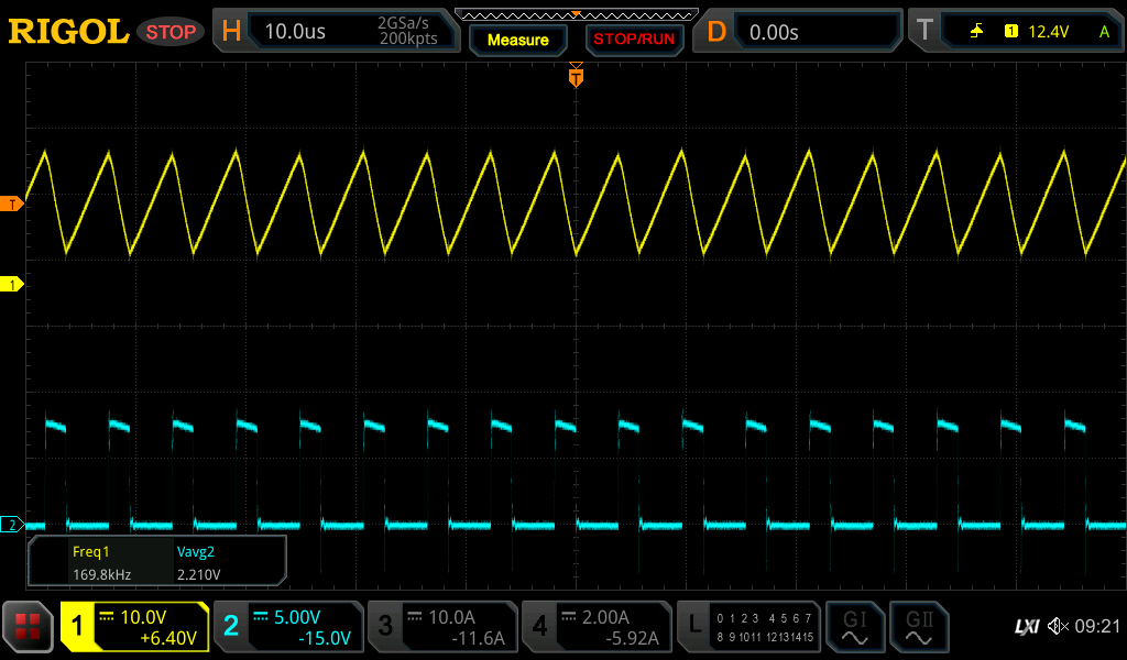

  • Hi Niklas,
    I think I found the problem, but I don't know what the solution is.
    In this application, the boost circuit charges a capacitor bank up to 50V then simply maintains the charge in the caps until the energy is needed. There is a very small load on the boost circuit once the caps are charged. I changed the load to 1mA in the calculator tool and it proposed an inductor value of 23mH.
    Could the problem be caused by a small inductor value (33uH) and light load? (33uH was chosen for a 1A load)
    It's difficult for me to measure as I don't own a HF current probe, but it looks like the drain current might be very high during the FET on time (possibly >30A). Would this be a result of inductor saturation? This could easily be the cause of the FET overheating.
    Is the LM5122 capable of a wide range of load currents (1mA to 1.1A) using the same inductor? What would that indutor value have to be?
    Perhaps there is a different device/solution from TI that might be more appropriate for this application?
  • Hi Lee,
    The quickstart calculator always calculates the inductance for CCM operation and for the maximum load.
    At light loads, the device will change to DCM operation or even skip mode operation and is still stable. (If you type in 1mA for the maximum load, the calculator recommends a much higher inductance, as it wants to achieve CCM operation a 1mA, which does not make sense for this application)
    LM5122 is definitely capable of support this load range and the inductor should also be suitable for this application.

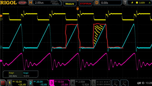

    The drain current spike might not be related to the inductor either, but could come the MOSFETs themselves.
    A colleague highlighted that the gate charge of the MOSFET part is very large.
    Looking at the waveform, it looks like the MOSFET is turning off very very slow. --> yellow gate signal has a sharp falling edge, but blue Vds voltage rises linear and very slow.
    In an ideal design, you would want an instant rise of the Vds voltage, as the MOSFET fully turns off.
    The area marked with yellow would all be losses on the MOSFET.
    One idea would be to add a discharge resistor for the MOSFET between gate and source (e.g. 10kOhm) to turn off the switch faster and reduce losses.
    Otherwise, it would be required to select a different MOSFET part with smaller gate charge that can switch faster.

    If the FET turns off slowly, does that mean that the LM5122 does not drive the gate low, only high? Shouldn't the LM5122 pull the gate low during the off period? If that's true then what benefit would a 10k gate pull-down have? I'll give this a try anyway.
    I assumed that the slowly rising drain Voltage was actually the inductor Voltage rising as it discharges. What should these waveforms look like in a boost circuit that's working, do you have any example scope traces you could share?
