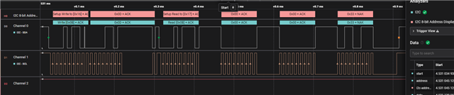

We have the following questions.  Could you please answer them?
*1. Could you please let us know how to confirm current mode, ROM mode or FW mode?
Also, could you please let us know where this is described?   We want to know the particular page of TRM/Datasheet.
*2. Could you please let us know how to change ROM mode to FW mode?
We can find the following sentence on bq40z50 TRM (SLUUA43A).
>> To return from ROM mode to FW mode, issue the SMBus command 0x08.
Does this mean MCU write 0x08 on Address 0x0B?   Although I think This is fundamental question, please let us know.
