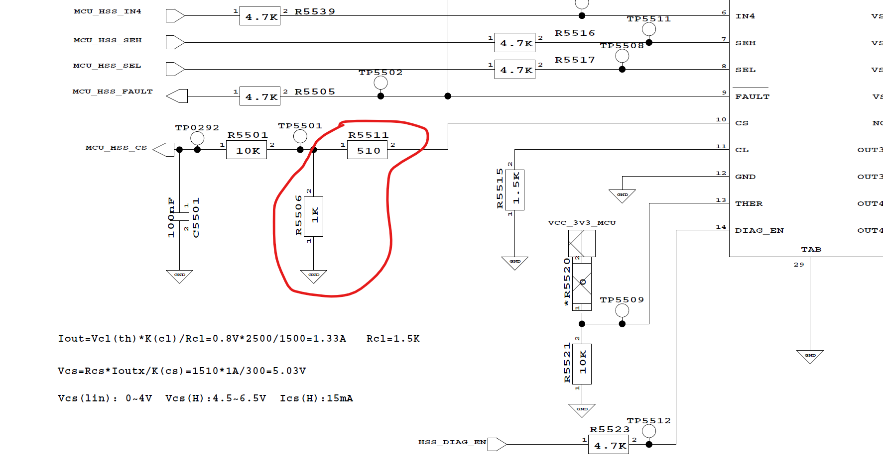

Hi, TI team:

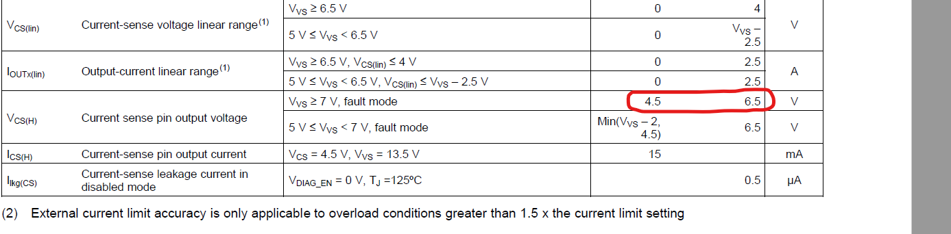

could you tell me the CS pin(10 pin) output voltage and current when in the fault mode? our Vvs = 11.5V.
I find the value is 4.5-6.5V in the datasheet, it is right?
Please check the CS pin divide resistor value, I used 510R and 1K, so when in the fault mode, CS pin voltage is 3V ~ 4.5V? my MCU pin is 3.3V, so I worry the 4.5V will damage MCU, do I need change the divide resistor to 510R and 510R? the CS pin voltage is 2.25V ~ 3.25V, it will not damage MCU pin?

  • Hey,
    Thank you for your patience. Yes, the divider will have to be adjusted for 3.3V.
    For example,
    From the datasheet the RCS is picked based on the linear range of the VCS (4V).
    VCS FLT = 6.5V -> 3.3V (to protect MCU)
    VCS linear = 4V ->2.3V (1V band for FLT cases)
    Since the fault high is lowered the linear range has to be lowered as well. 3.3V will be the fault high the RCS can be selected for a range of 2.3V.
     -> ((2.3V x 300) / 1) = 690
    Since the FLT high voltage from IC (6.5V), RCS resistance (690), and the final voltage (3.3V) is determined we can solve for R1 in the divider.
    VOUT = VIN (R2 / (R1 + R2)) -> 3.3V = 6.5 (690 / (X + 690)
    R1 = 669

  • Hi, Alan:
    thanks for your reply.
    your calculation is for VCS fault = 6.5V,  but the datasheet shows VCS fault is 4.5V - 6.5V, So if the VCS FLT is 4.5V, 690 and 669 are ok?
  • Hey,
    I just assumed the worst case to ensure protection of the MCU. These resistor values should be sufficient.
    BR,
    Alan

  • Hi, Alan:
    so when shorted happened, the chip will turn off the output, right?
    and could you tell me how to calculate the CS pin voltage?  it is depend on R5511/5506?
    my SW team asked me the MCU_HSS_CS voltage when chip works normally and abnormally, they will set the threshold value
  • Hey,
    Yes, for better protection from a hard short-to-GND condition (when the INx pins are enabled, a short to GND occurs suddenly), the device implements a fast-trip protection to turn off the related channel before the current-limit closed loop is set up. The fast-trip response time is less than 1 μs, typically.
    5501 and 5511 will create a voltage divider on the spec above so using the divider equation R(CS) = 5506 is chosen.
    BR,
    Alan
  • Hi, Alan:
    If this chip output current is 1A, could you tell me CS pin will output how big current?  1A/300 = 3.3mA?
  • One integrated current mirror can source 1 / K(CS) of the load current. The mirrored current flows into the CS-pin resistor to become a voltage signal.
