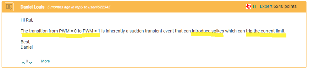

  • Hi Jaron,
    ...at the same beginning many thanks for your activity
    In this case, I have chosen the most credible answer in my opinion, underlined in yellow
    ...so, answer in the datasheet should sound that the upper threshold 700mV is related with the Spikes. I do not know that it goes such as without saying.
    OK, thank you in advance for this.
    Simultaneously, I have to be conscious of this spikes every time:
    - when I will turn on the PWM function from normal operation (from Vref=5V (100%) to 1.35V (17%) on the PWM/DIM input) and;
    - when i have PWM signal (from HIGH state to LOW and from LOW state to HIGH, etc.), 1.35V (17%) on the PWM/DIM input);
    - when I will back to normal operation from the PWM function (from 1.35V (17%) to Vref=5V (100%) on the PWM/DIM input);
    At the 10nF connected to the RAMP pin, f = 250Hz, so the spikes will be exist (can exist) at every PWM state change, i.e. from HIGH state to LOW and from LOW state to HIGH. If on the Ris=62mR the voltage will reach value close to the ~700mV but no more then 700mV (Ipk=~700mV/62mR=11Amps), should the PULSED DRAIN CURRENT of the main transistor be taken into account ?
    I think the worst case scenario is for PWM=50% and for the maximum PWM dimming frequency (frequency of the internal PWM ramp generator) Pdim=2kHz
