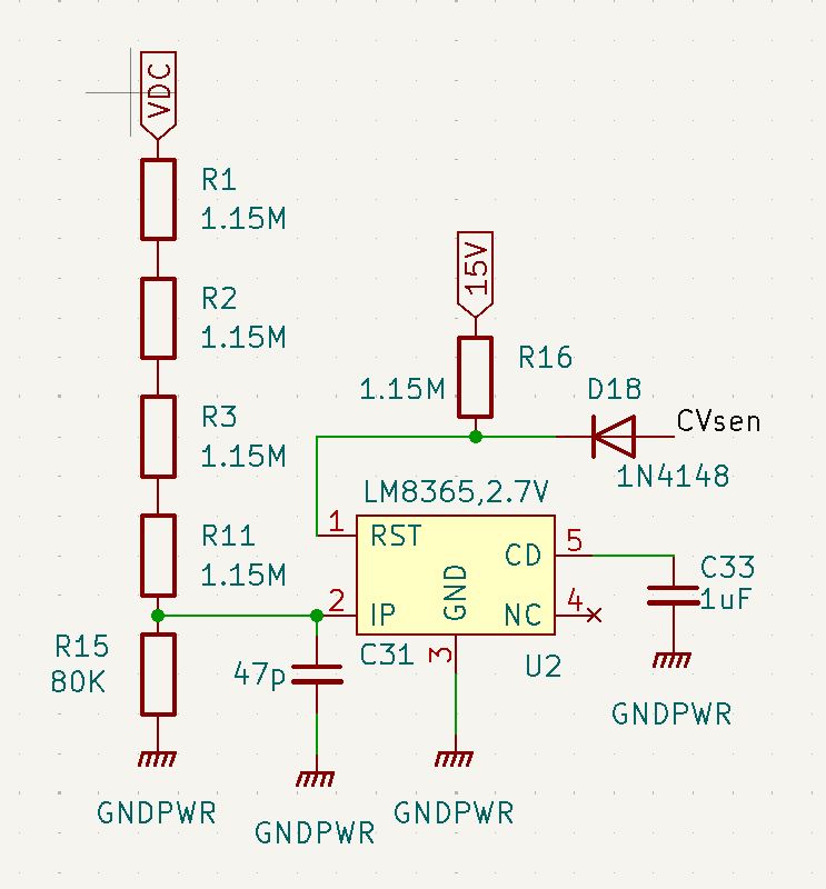

I need a support for Correct brownout function ic for UCC28180D PFC controller 1000W , i tried with LM8365 reset ic based on  your thread using LM8364.
Schematic added and Label Cven connected to 6 th pin of UCC28180D

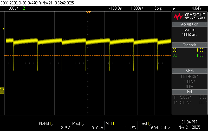

Input voltage 124VAC  the output should be > 2.85v at the 2nd pin of LM8365  but there is a voltage down and up .
The screenshot shows input voltage around 307V dc ( bus voltage)
The screenshot shows input voltage around 307V without Lm8365
    Immediately I notice that the RESET pin of LM8365 in your schematic is pulled up to 15V, which violates the absolute maximum rating of the device. We have a range of high voltage supervisors that will likely be a better choice for this application. A device such as TPS3842 or potentially TPS371K-Q1 may be more appropriate for this application.
    I do not have a clear understanding of the application, are you able to provide a more complete schematic showing how LM8365 is connected to the rest of the circuit? Additionally, oscilloscope captures showing both the input and reset pin of LM8365 will be helpful.
    -Henry

    Thank you for your mail, i found Reset pin voltage maximum is 6V so I updated with voltage divider, i ll take forward as you suggested high voltage ic in further steps , please check the schematic as you requested
    Also captured the oscillasope
    Top one is at reset pin diode output
    Bottom one is at 2nd pin
    Thank you for providing the full schematic. I believe the issue may be related to the LM8365 not getting enough current and therefore releasing the reset signal. Can you try increasing the value of C31 to 0.1µF and test again?

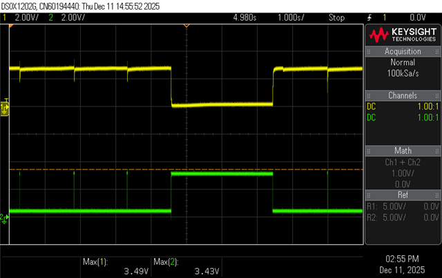

  • Yes yellow is Input and green is reset output,
    Yes LM8365 works correctly with out PFC turnrd ON, means i removed Mosfet gate resitor.
    below imgage shows clearly there is multiple reset if i connec Mosfet gate resitor (PFC).  need solution for this !
    I'd like to clarify that the LM8365 is working as expected in the latest oscilloscope capture you've sent. I've created a timing diagram to explain the behavior more clearly.
    At time t1, when the input voltage is below 1V, there is not enough voltage to pull-down the reset output, so it will be a logic high. Once the input rises above 1V but is below 2.7V (t2) the reset output will assert, pulling down the reset. Then when the input rises above 2.7V (t3), the reset will release after ~1.2s. Once the delay has elapsed (t4), the reset goes high, which seems to be causing the input voltage to drop and therefore the reset asserts again (t5). After a short period, the input rises again (t6) which causes the reset to release after ~1.2s, and the cycle repeats.
    Since the LM8365 is working as expected, there is not much more support I can provide in this thread. I recommend creating a new thread related to the UCC28180D if additional assistance is required.
    -Henry
