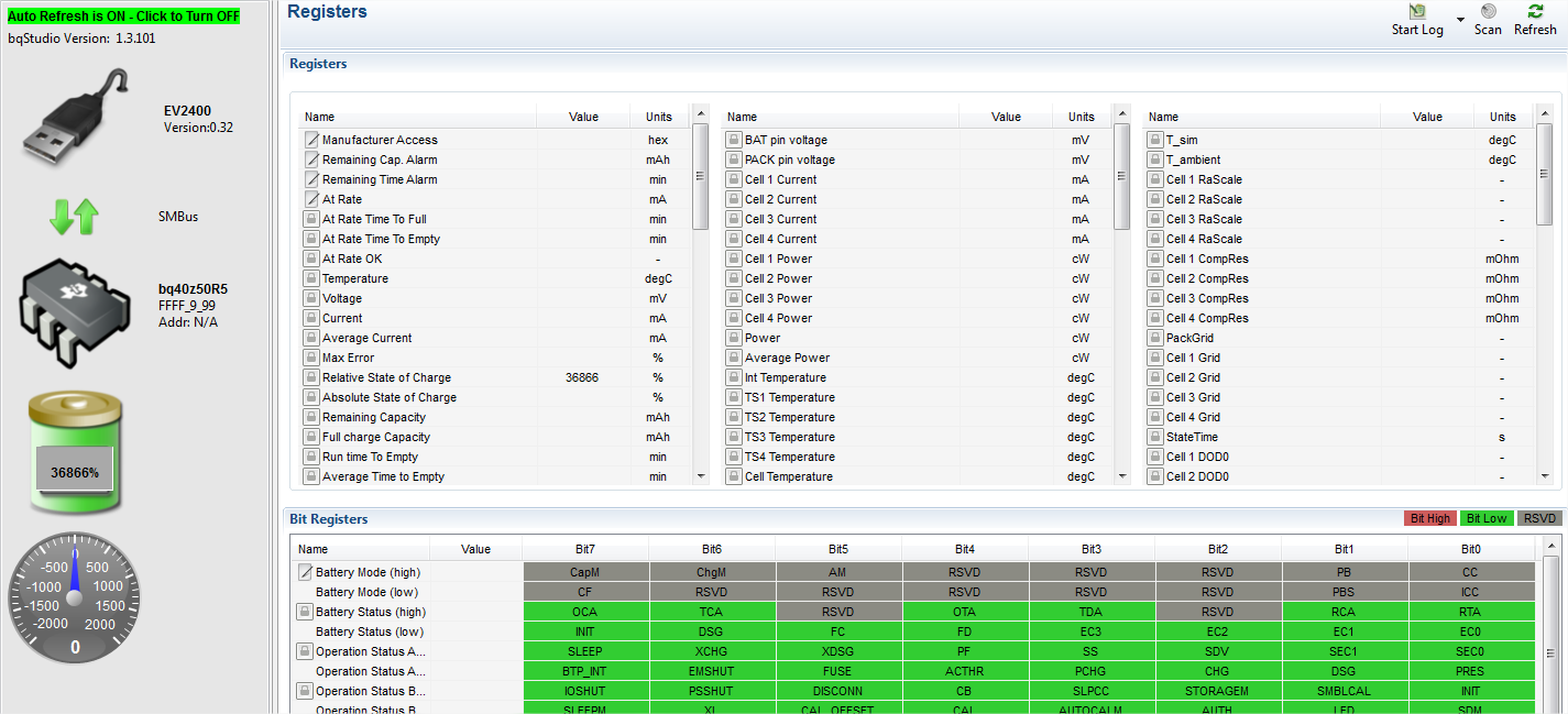

When I was performing SREC programming, the system interrupted the programming process halfway (so the programming was likely not completed). After that, the EV2400 was no longer able to connect to the device.
After reopening BQStudio, the system asks me to select the Gas Gauge part number being used, and then displays the following screen for about 2 seconds as below picture.

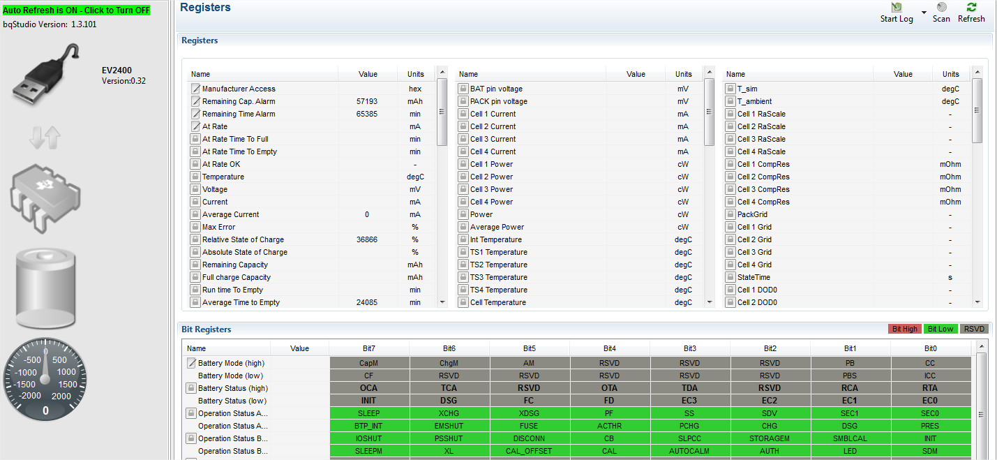

After 2 seconds, the EV2400 is unable to connect to the device, as shown in the image below. After that, the device can no longer be programmed with the SREC file.
I try to read gauge, it show "9002" as below.
May I know how to solve this issue?

  • Hi Alan,
    Thanks for your feedback.
    I already solve this issue.
    Step as below:
       1. Remove the battery cell
       2. Discharge all capacitors related to the gas gauge
       3. Assembly battery cell
       4. Wake up gas gauge (Pack pin voltage > Vshutdown+)
       5. Turn on Bqstudio and select part number
       6. Programming the SERC file as quickly as possible when the BQ software is opened
       7. If programming still failed, repeat steps 1 to 6.
    Jason
