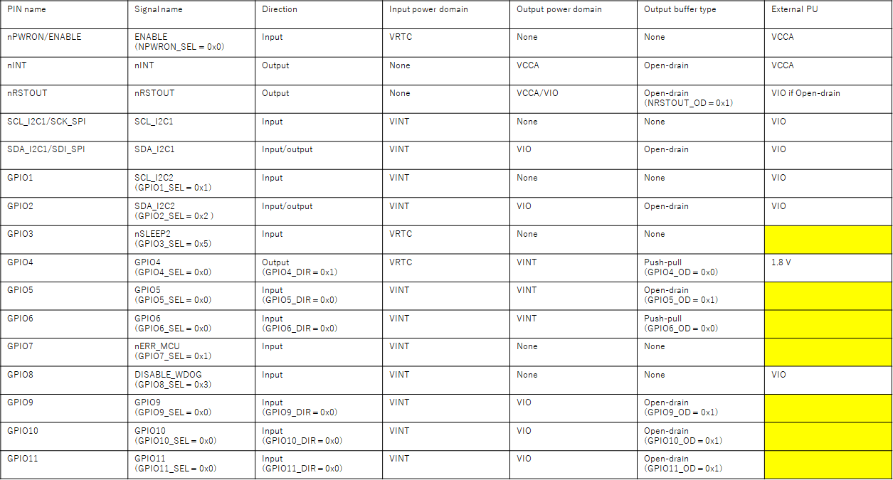

  • Hi Katie-san,
    Thank you for your reply.
    My first post contained several typos. It is not the questions about specific GPIO pins (GPIO1 and GPIO5). I want to clarify the power sources that can be connected for each of the IO signals requiring a pull-up.
    Can the IO pins configured as input be connected to VIO (3.3V)?
    If not, then they should be connected to 1.8V.
    Can they be connected to BUCK5 (1.8V)?
    If not, does 1.8V need to be derived by dividing 3.3V?
    Daisuke

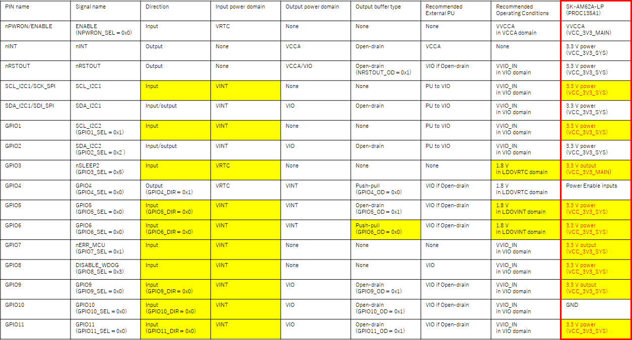

  • Hi Nicholas McNamara-san,
    I checked the connections of the IO pins on SK-AM62A-LP (PROC135A1). Most of them were pulled up to 3.3V (same voltage level as VIO_IN).
    Can the IO pins below with the specified configuration really be pulled-up to 3.3V?
    For GPIO3/4/5/6, they use the VRTC or VINT domain. The voltage on the logic pins is 1.8V under the recommended operating conditions.
    For I2C and SPI pins and other GPIO pins, the voltage on those logic pins in VIO domain is the same as VIO_IN under the recommended operating conditions. But they use the VINT domain as input.
    Daisuke

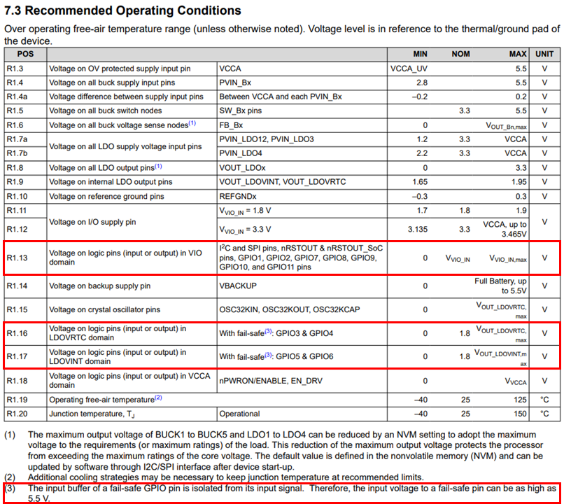

    Thank you for your support. Our customer is waiting for your reply.
    Should we refer only to the "Recommended Operating Conditions" for the voltage on each of the logic pins? In other words, regardless of the power domain used, can we refer only to R1.16 for GPIO3/4, R1.17 for GPIO5/6, and R1.13 for I2C and SPI pins and other GPIO pins?
    If my understanding is correct, GPIO3/4/5/6 can be pulled up as high as 5.5 V when configured as input, and I2C and SPI pins and other GPIO pins can be pulled up to the voltage of VIO_IN.
    Please give me an answer as soon as possible. Your prompt reply would be appreciated.
    Daisuke
  • Hello Daisuke,
    My apologies on the late reply, you are correct with the fail safe the input voltage on these domains can be as high as 5V5, but the fail-safe. Now the fail-safe on the input buffer is tied to the input power requirement and due to the VIO_IN & VCCA being tied together this is not an issue.
    This is not an issue due to VCCA powering the device while simultaneously providing the input voltage at the above pins of concern, so there isn't a mode in which you will fail outside of recommended operating conditions, which is why typically for 3V3 input applications we ask customers to tie in VCCA & VIO_IN for simplicity.
    If 5V0 input is used, please follow the recommendations of the User's Guide for the PMIC TPS65931211 as there will be a change in the assumptions of the voltage since 5V0 is no longer a recommend voltage level for the VIO pin.
    Thank you for your reply. I’m sorry for asking the same thing repeatedly.
    I understand the concern especially looking at the block diagram, as you can see for the pins 3,4, 5, & 6 which use exclusively the internal LDOs for the sources of the 4 pins for both the input and output buffers. The architecture for the GPIOs are different, hence the different line items you pointed out in the specifications section.
    As described in note (3) of the “Recommended Operating Conditions” GPIO3/4/5/6 can be pulled up as high as 5.5 V when configured as input, correct?
    And they can be pulled up to 5.5 V regardless of the voltage applied to VIO_IN, correct?
    "(3) The input buffer of a fail-safe GPIO pin is isolated from its input signal. Therefore, the input voltage to a fail-safe pin can be as high as 5.5 V."
    For all other GPIO pins the input and output buffers are split between LDOVINT and VIO_IN, the specifications are correct, 3V3 is allowable on the other GPIO pins, in this case input 3V3.
    Other IO pins can be pulled up to 3.3 V (VIO_IN) when configured as input, correct?
    Our customer is referring to SK-AM62A-LP for their custom board design using AM62A7 and TPS65931211-Q1, but VDDA uses 5V instead of 3.3V.
    Please clarify whether IO pins using VINT/VRTC (1.8V) can be pulled up to 3.3V (VIO_IN).
    Daisuke
  • Hello Daisuke,
    Only when power is applied to the VCCA pin, as the input buffer requires power to function, so this fail safe is only applicable when VCCA > VCCA_UVLO
    Only applies to the pins noted in (3), so yes that's correct with the exception above.
    That is correct, from the recommended specifications for all other IO pins.
    I understand the input voltage on each IO pin as follows.
    For nPWRON/ENABLE (input) pin, R1.18 in the "Recommended Operating Conditions" applies. Therefore, the pin can input up to 5.5 V (VVCCA).
    For nINT (open‑drain output) pin, "RECOMMENDED EXTERNAL PU/PD" in the "Table 6-2. Signal Descriptions" applies. Therefore, the pin can input up to 5.5 V (VVCCA).
    For GPIO3/4/5/6 pins, when configured as input or open‑drain output, Note (3) in the "Recommended Operating Conditions" applies. Therefore, the pins can be input as high as 5.5 V if VCCA > VCCA_UVLO.
    For nRSTOUT, I2C and SPI pins and other GPIO pins, when configured as input or open‑drain output, R1.13 in the "Recommended Operating Conditions" applies. Therefore, the pins can input up to 3.3 V (VVIO_IN).
    Our customer will refer to SK‑AM62A‑LP (PROC135A1) for pull-up on each IO pin.
    I would appreciate it if you could point out any errors in my understanding.
    Daisuke
    Happy New Year. Thank you for your reply.
    The latest revision of the SK‑AM62A‑LP is PROC135A1, so we should refer to PROC135A1 (the design file below), not PROC135E2, right?
    SK-AM62A-LP Design File Package (ANF)
    Daisuke
  • Hello Daisuke,
    If that is in fact the latest, please go ahead with that revision of the board, my apologies with slower responses.
    If there is a major difference between the E2 vs A1 regarding PMIC connections, please do raise a question as you deserve answer, but as for as the IO and pull up connections I do not see and issue on the voltage levels.
