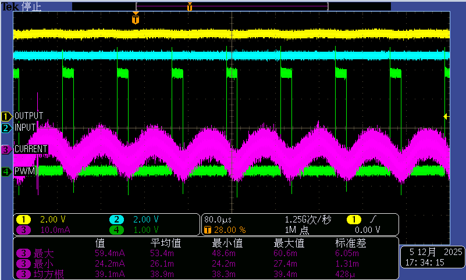

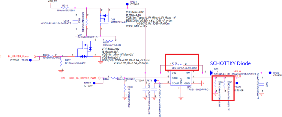

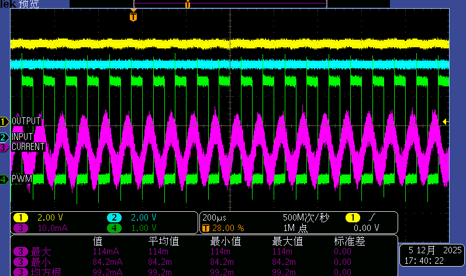

We tested the TPS61165 with the maximum current set to 200 mA, using a 22 µH inductor and PWM at 25/50/100%. We observed spikes in the current waveform, with a period of about 5 ms. Is this behavior normal? Thanks.
PWM 100%
PWM 50%
PWM 25%

Hi
Could you help confirm the current is from inductor or the LED? Could you help capture the LED current if possible? and you can try with a smaller 10uH inductor to see if any improrvement here.
