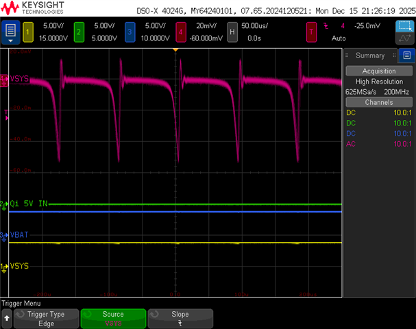

I am struggling with a voltage ripple on the SYS output voltage. This ripple voltage only occurs under a certain condition. SYS supplies my electronics, on BAT there is a rechargeable battery with 750mAh connected and on the IN input there is a wireless charging system connected which is providing +5V when a charging pad is present.
Sometimes, when I remove the charging pad from the wireless charging part, a voltage ripple on the SYS voltage appears. Means when the power source of SYS changes from IN to BAT this voltage ripple appears on the SYS voltage. A Hard Reset of the BQ25180 makes the ripple disappear.
The shape and frequency of the ripple depends on the load current at the SYS voltage.
The voltage of SYS is equal to the BAT voltage, LIPO voltage 3.7V-4.2V. The ripple with a 100kOhm load on SYS has a sawtooth shape with 40mV amplitude and a frequency of 485Hz.

    So far, I could only reproduce this issue by removing the charging pad, which means when the power source for SYS changes from IN to BAT. Initially this issue occurred with our electronic as the load on SYS, but in the meantime, I have isolated the charger chip part from the electronics. On SYS is now only an ohmic resistor decade as the load.
    I also uploaded some oscilloscope pictures. If you see the SYS ripple, the channel is on AC coupling. On the picture BQ25180_Issue.png, the yellow VSYS Signal is on DC coupling.
    Thanks and best regards
    Christian
    1k load:
    10k load:
    100k load:
    100R load:
    BQ25180_Issue:

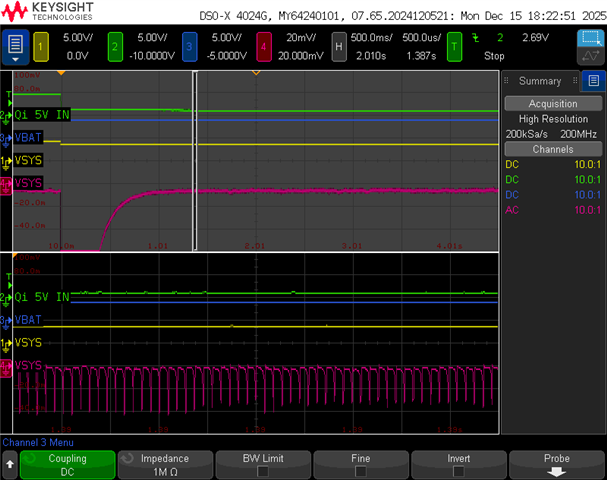

  • Hi Christian,
    Could you zoom in on VIN, VBAT, and VSYS at the moment the device is removed from the wireless pad?
    In the BQ25180_Issue capture, it looks like VSYS on the DC-coupled channel stays at the same voltage the entire time. From the register settings you shared, VSYS is regulated to 4.6V when a 5V input source is connected. When the device is removed from the wireless pad, I would expect VSYS to fall from 4.6V to the battery voltage. A zoomed in capture would help confirm whether this is the case.
    It looks like the ripple increases a few seconds after the device is removed from the wireless pad. Is anything happening during this time? Is the load on the decade box being increased, or does this ripple always just appear after a few seconds?
    Alec
  • Hi Alec,
    Sorry I was not writing it correctly, in the picture BQ25180_Issue the load is still our electronics, not an ohmic load. After removing the charging pad, the oscillation starts, but the electronics is still running and the current is high, therefor the oscillation frequency is higher. After around 2.5 seconds our device goes into a sleep mode, the load current decreases and the oscillation frequency changes. The Amplitude of the oscillation looks small in the first 2.5 seconds and much bigger after that, but this is just a resolution problem of the saved .png file.
    VBAT was quite high in the picture and you just don't see the jump from 4.6V to VBAT of the VSYS voltage, also a resolution problem.
    I made new pictures where you can see it in a better way. You can see, the ripple starts right away and the VSYS (Yellow) jumps from 4.6V to VBAT.
    To me it really looks like the power source switch from IN to BAT starts the oscillation. I also added our Schematic part of the BQ25180.
    Christian

  • Hi Christian,
    Just to confirm, is the MCU still connected to SYS in these waveforms? If the ripple increases when the MCU goes into sleep mode around 2.5 seconds after removing the input source, it seems the ripple could be related to the MCU.
    I did some testing on a BQ25180 EVM using a resistor decade box connected to SYS and your register settings. I did not see any ripple after disconnecting the input source. How repeatable is this issue on your end?

    I disconnected the Alkaline Batteries from the VIN pin. I had to do this several times and suddenly the ripple was there!
    I measured VSYS with AC Coupling and 20mV/DIV and 50us/DIV:
    VIN Voltage = green
    VSYS AC Coupling = red
    VBAT Voltage = blue
    VSYS DC Coupling = yellow
    This is the ripple after disconnecting the VIN voltage (zoomed in):
    and a little bit later:
    Please try it again to reproduce the issue with your EVALBoard.
