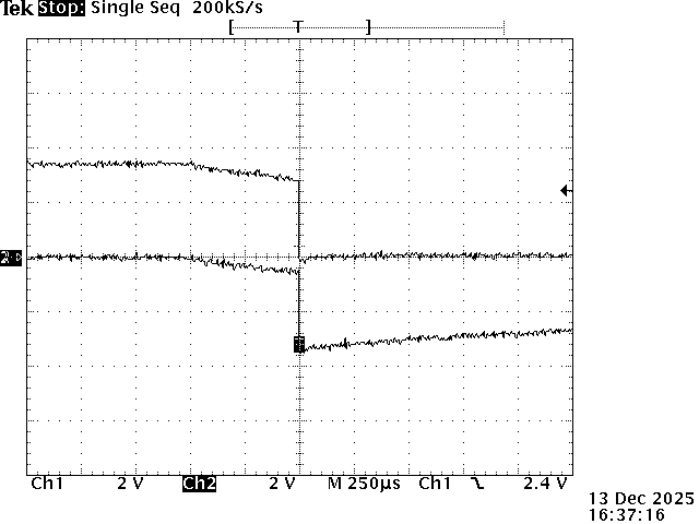

  • Hi Ole,
    I ran simulation on this and C67 should be discharged much slower than VCAT. Can you share the waveform of EN, gate of Q3, and VCAT? trigger EN falling edge to capture the moment when EN turns low. use 200us/div as time scale

    I managed to get three shot for you. It seems that I can only attach one at a time.
    TEK00003.bmp:
    Ch1 (top): SAFE_EN_VCAT from the AND-gate disables the converter when falling (used as trigger).
    Ch2 (bottom): /DISCHARGE_:VCAT from RC midpoint goes negative and enables the PMOS transistor. It slowly discharges (RC = 1µF*10 kohms).

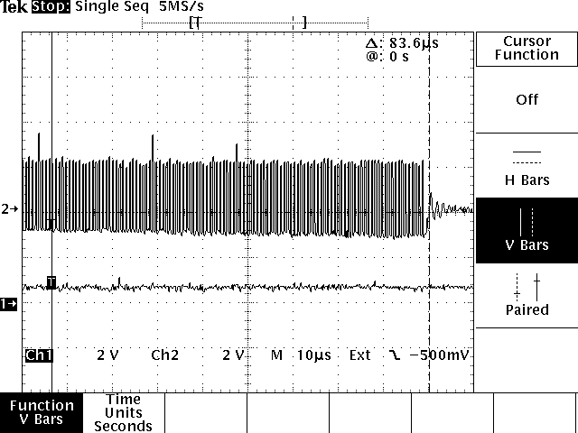

  • Hi Ole,
    The other waveforms looks good. It looks like your circuit discharges the VCAT normally as expected. The problem is that the IC seems to be switching again. The sample rate is too low so we cannot see the details of the SW voltage. But I suspect there's switching behavior here:
    So can you help zooming in this moment to 20us/div with higher SR rate? Please add EN signal so that we can see whether it's enabled again.
    Travis
  • Hi Travis
    Here are the waveforms for EN (Ch1) and SW (Ch2) with VCAT falling edge at -500 mV used as external trigger (i.e. where the transistor stops conducting).
    Surely, looks like your suspicion with respect to EN (close to 0.9 V) was correct.

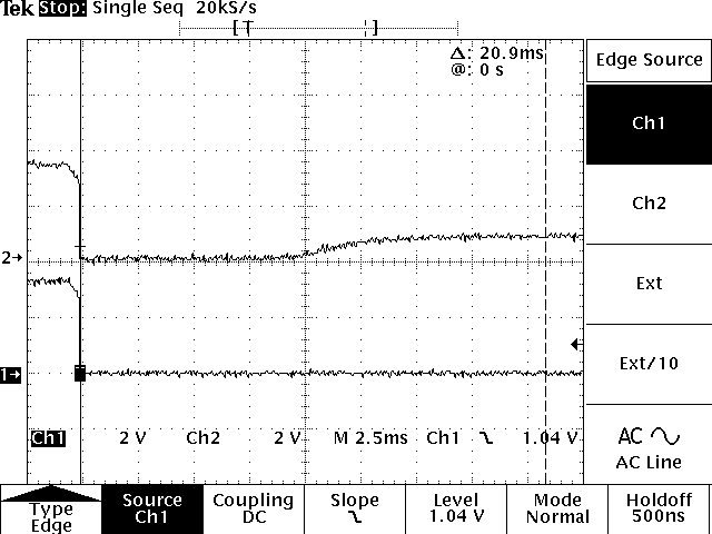

    The net SAFE_EN_CAT is supposed to be driven by the AND-gate (U9B) output, and I suspected that the gate failed driving the output to a low level when its supply voltage is very low. Thus I wanted to check whether the other half of the dual AND-gate (U9A) that shares the same supply has the same output behaviour at very low supply voltage. This gate has inputs PG_3.3V and PG_1.8V, and output PG_POS_B (received in cathode_supply.pdf to the left). The waveforms below are PG_POS_B (Ch1) and EN (SAFE_EN_VCAT) (Ch2).
    To me it looks like both AND-gates are capable to drive both signals to 0 V as they should, but that something else later is driving the net slowly to around 900 mV V just starting10 ms after the 3.3 V and 1.8 V are out of spec. This could point to the RC-cicuit with its constant of 10 ms. I suspect that the capacitor (C67), when the the AND-gate presumably goes high-Z, goes from 0 V on its left side and, say, -900 mV on its right side to +900 mV on the right side and 0 V on the left side, thus potentially restarting the converter.

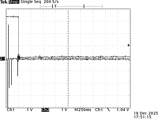

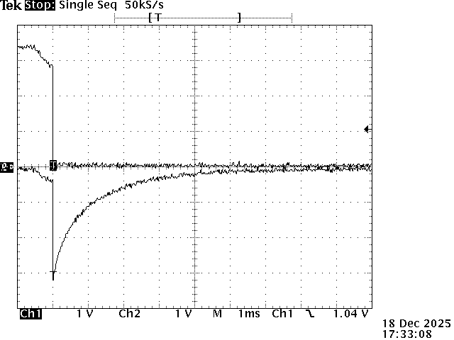

    Here are waveforms for 3.3 V (Ch1) supplying the U9A/B dual AND-gate and the output (Ch2) of the AND-gate U9B when the power +5 V to the board is turned off. The trigger is the falling edge of the output corresponding to the EN signal of the DC/DC converter. The output is also connected to the capacitor, which I suspect raises the voltage of the EN signal, when the AND-gate ceases to function.
    Luckily I saw your response above as the usual notification e-mail never showed up.
    For R46 = 100 kohm, i.e. RC = 100 ms:
    For R46 = 10 kohm, i.e. RC = 10 ms:
    Thank you for your help.
  • Hi Ole,
    I think your assumption is correct. The correct time sequence should be :Cout discharge finish-> C67 discharge to 0 -> Power supply of the AND gate drops. But now C67 drop slower than ADN gate power supply, which means the AND gate cannot pull C67 to GND. and EN signal is pushed high again by C67. So the solution would be increasing the capacitor on AND gate power supply or reducing RC parameter on C67.

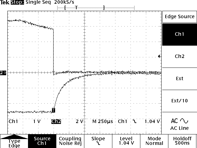

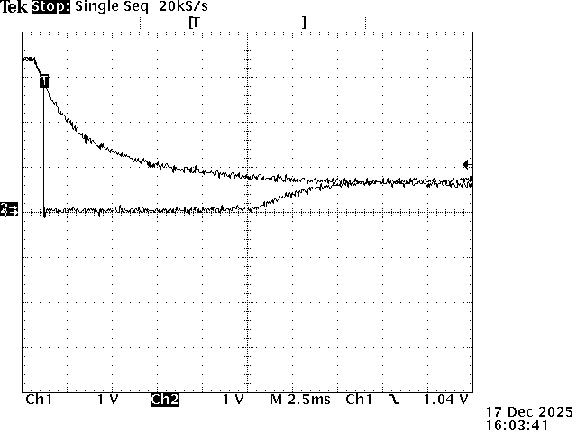

  • Hi Travis
    I also got the idea this morning to reduce the RC parameter. With R46 at 1 kohm things look right as can be seen by the waveforms below that all trigger on EN (Ch1) going low. Thank you very much for your help and patience in getting a good and clean solution.
    EN and VCAT (-5 V)
    EN and /DISCHARGE_VCAT (Q3 gate)
