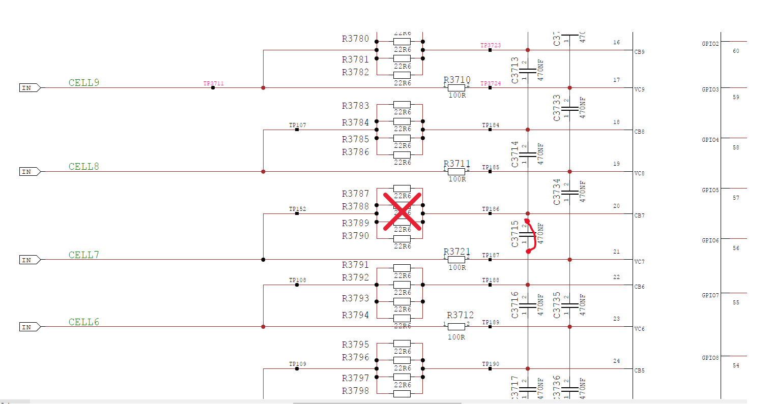

BQ75614-Q1: How to crossover busbar for BQ75614
Part Number: BQ75614-Q1
Other Parts Discussed in Thread: BQ79616-Q1
Hi TI colleagues ,
1,Now we need to crossover one busbar between cell6 and cell7 . when the battery is discharging with 1000A,  there is about minus 2V , but Between CB6 and cb7 only can suffer minus 0.3V .  How to do ?
2, if we do as below schematic ,remove R3787,R3788,R3789,R3790, short C3715 ,  is it OK ?
 Thank you !
