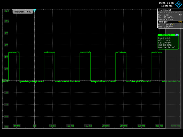

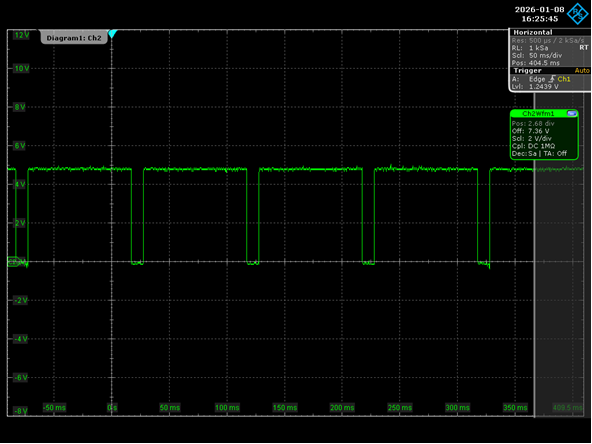

  • Dear Arnold,
    Thank you for your support.
    I will let you know the result of the test you mentioned once the test is done.
    And my customer did some test, Please give me some advice about it.
    - Measured NFAULT/GPIO2 (P53)
    1) In case of normal status
    2) In case of UV(Under Voltage) status - NFAULT pin is unstable, neither high nor low.
    I think NFAULT should be stable low under UV situation.
    Could you give me advice about case 2?
    Chase
  • Hey Chase,
    Thank you for sending these over. I think I understand the waveforms but just to check -- what is the context of these waveforms? Are these captures of nFault in a system where commands are executed cyclically? It seems that in case 1 there are also faults being detected which causes nFault to drop and then faults are being reset. Could you give me more information about what communication is being sent to the device / what commands are being sent and what faults are being introduced and also when those faults are getting cleared?
    Regarding test case 2, those results are very feasible depending on the customer's procedure. If faults are getting cleared, it does make sense for nFault to only fall occasionally. If the customer is using round robin mode, Section 6.3.5.1.2.1 of the datasheet explains how ovuv checks are performed and that the time between cyclic is approximately tOVUV_CYCLE_ACT_MULTI, or ~70ms according to page 15 of the datasheet. If the customer is using single mode, this also makes sense since ovuv would not be continuously running. Additionally, fi the device is in sleep mode during the customer's cycle, then the ovuv cycle has a different delay.
