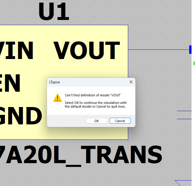

Dear Team,
Could you please provide the spice model/TINA Example circuit for  TPS7A20L, 3.3V output version.
The one available in the website is wrong.
HARI
  • Hi Hari,
    The published TPS7A20 model is fine.  You must set the parameter VOUT to be equal to the voltage variant you are using.  In PSpice this would be with the .PARAM statement, and setting VOUT equal to your output voltage.
    Stephen
  • Hi Stephan,
    Thank you.
    I have TINA-TI and LTSpice.
    If you have any model which works with TINA or LTspice it's good.
    I installed Spice for TI.(Need to learn it Slight smile )
    HARI
  • Hi Hari,
    If necessary you can go into the .PARAM section of the netlist and just set VOUT to be whatever output voltage you are working with.  For a 1V output it would look like this:
    VOUT = 1
    I would strongly consider using PSpice as that is what we do all of our development on, and is the main tool of choice for TI simulations.  Unfortunately we cannot offer support for LTSpice (or even download it) as the license agreement prevents any competitor from using that software.  You will have to reach out to ADI for support with LTSpice, if necessary.
    Stephen
  • Hi Stephan,
    I will edit the file.May I know exactly where I need to make the change.
