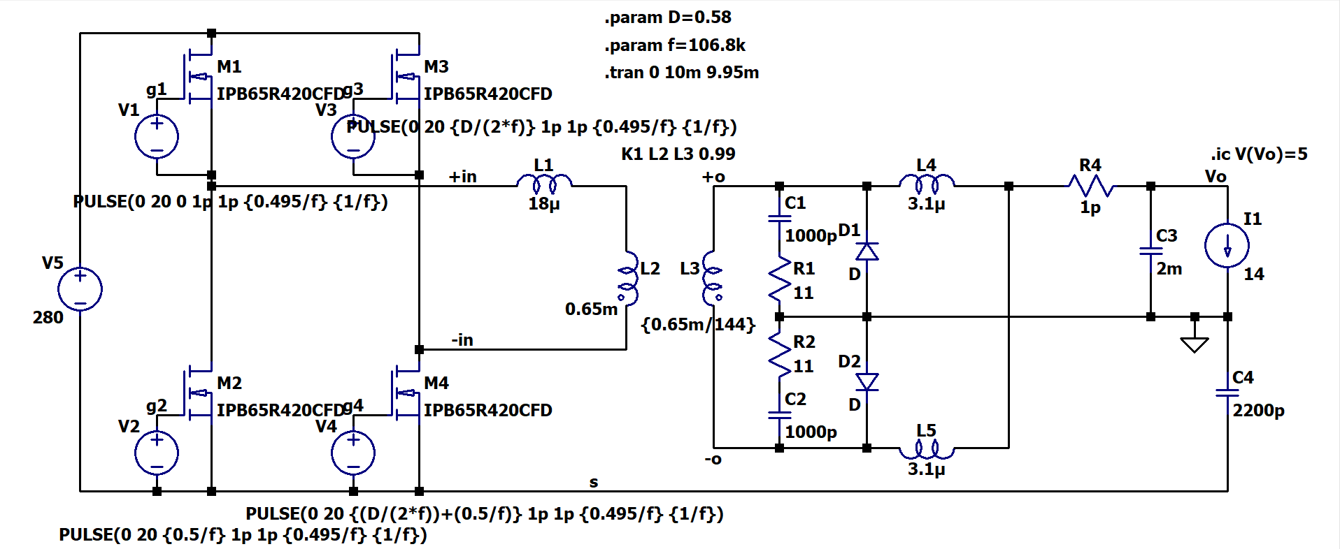

I design a phase-shift full-bridge converter useing the UCC28951.
The design condition are as follows:
Input Voltage Min.250V Typ.280V Max. 300V
Output Voltage Typ.5V
Output Current Max. 14A
Output Power Max. 70W
Switching Frequency 106.8kHz (RT=56kohm)
I have two questions regarding the calculation formulas listed in the UCC28951 datasheet.

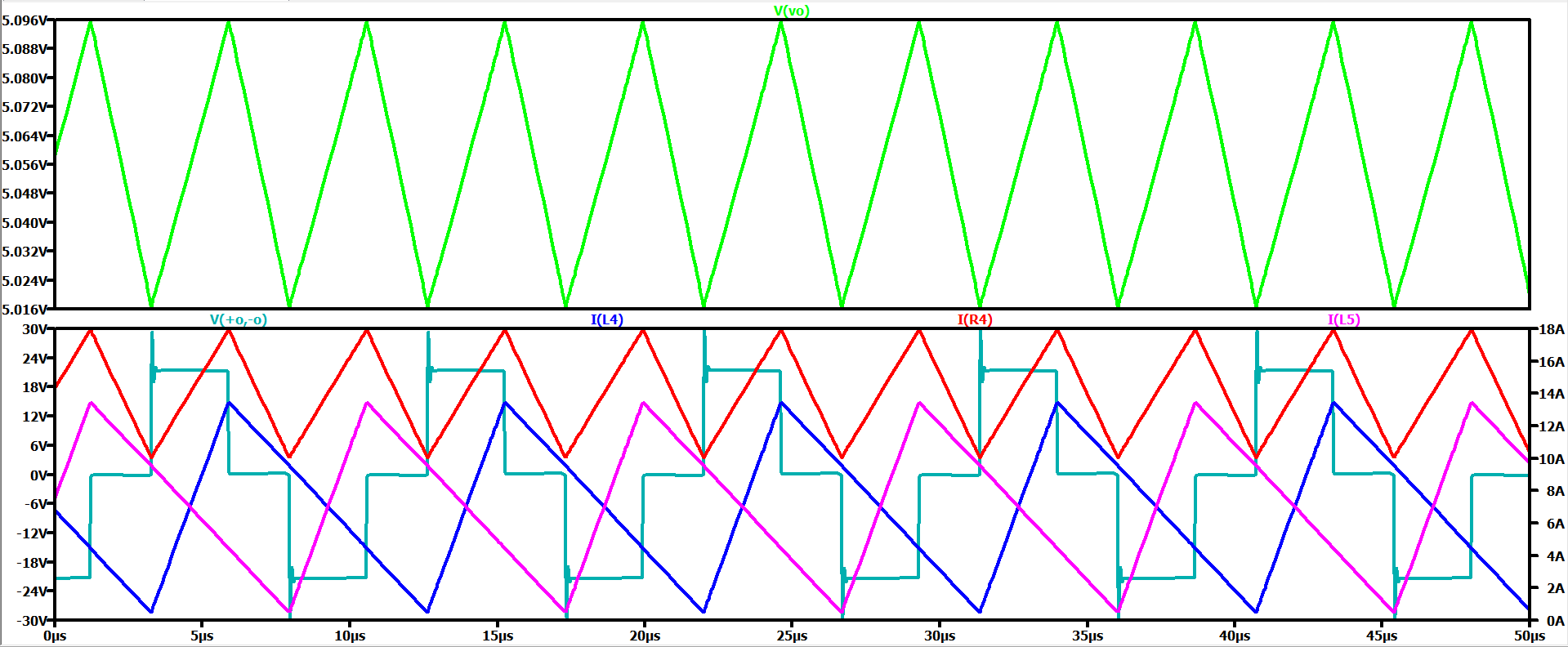

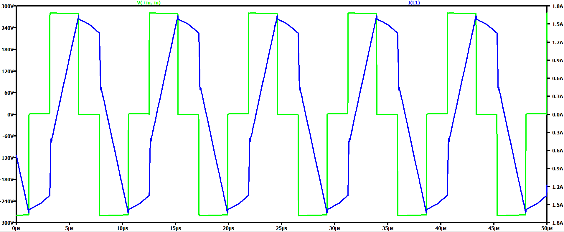

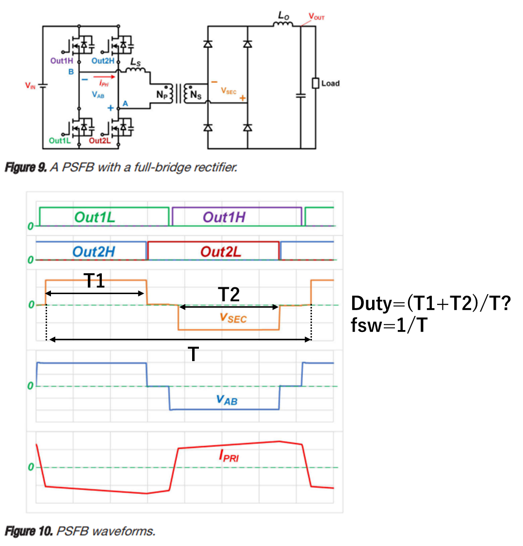

Q1.This is a question about the duty cycle. Is the method for calculating the duty cycle shown in the following diagram's formula correct?
Q2. We are currently designing with the circuit below. According to the datasheet calculations, the duty cycle D is 0.3, but in LTspice simulations, D is 0.6. Is it correct to understand that, with the rectification method shown in the following diagram, D becomes twice the value specified in the datasheet? Additionally, are there other parameters similar to D that should be taken into account?
