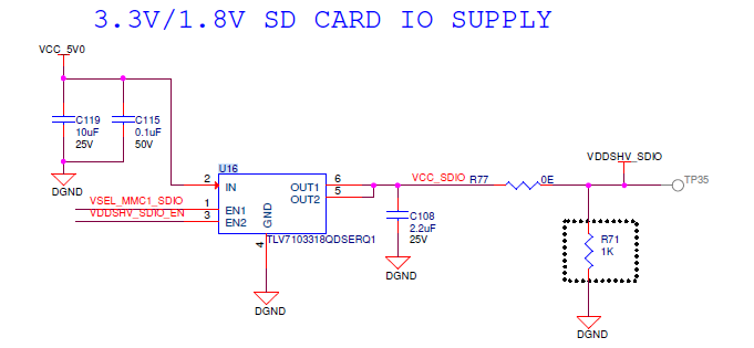

TLV710-Q1: TLV7103318QDSERQ1:- Output showing 1.1V
Part Number: TLV710-Q1
Hi Team,
We have used TLV7103318QDSERQ1 for SD card supply for our board, during the prototype phase the board was working with SD card booting. After some 100 board production we faced the issue that showing 1.1V instead of 1.8V on the out put side. could you please check and share what could be the reason for the same? image.png
Deepak
