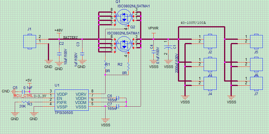

Hi I reviewed the TPSI3050 datasheet and forum. I have aquestion aboat tpsi3050 and tpsi3050s.
Can I understand it as meaning that tpsi3050/tpsi3050s all can be used to keep the MOS in continuous conduction?
  TPSI3050S: VDDP supplies power to the isolated VDDH. Control the ON/OFF state of the MOS transistor through the EN  logic level.
  TPSI3050: EN PIN  supplies power to the isolated VDDH and VDDP. Control the ON/OFF state of the MOS transistor through the EN threshold voltage(6.5V) .
  Is the above content correct? I have based this design on it and created the relevant switch schematic diagram. Could you please help me review schematic diagram?
  • Hello Lin,
    Thanks for joining E2E and reaching out to our team!
    Both TPSI3050 and TPSI3050S can receive power like this, I recommend using TPSI3050 in your application since TPSI3050S only sends single VDRV pulse when EN goes high. TPSI3050 will keep VDRV high when EN is high.
    I illustrated suggested sch changes below. Can you share whether you need to pass emissions compliance testing (like CISPR 25 or CISPR 32) for your application? If yes, need to recommend additional components.
  • Hi Tilden,
    We don't need to pass emissions compliance testing (like CISPR 25 or CISPR 32).OK,I will  modify it according to your suggestions.
