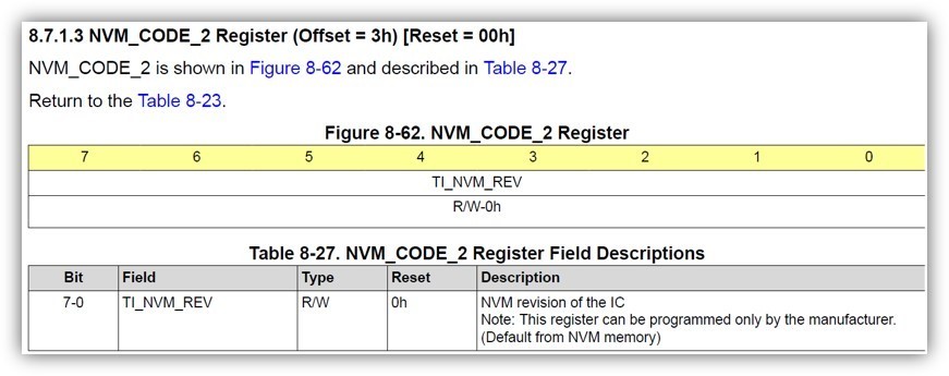

    2. How can we confirm that the TPS6594133A is revision 5?

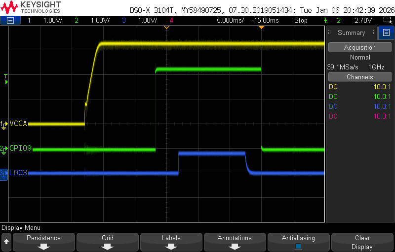

    3. GPIO9 retries 15 times, as shown in the waveform below.
    CH1:VCCA
    CH2:EN
    CH3:GPIO9
    CH4:BUCK3
    CH1:VCCA
    CH2:EN
    CH3:GPIO9
    CH4:LDO1
    Thanks!

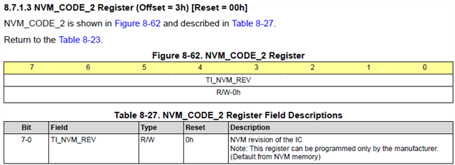

  • Hi Nicholas,
    We have read [3h]=05, is it mean revision 5? thanks!
    Jeff

  • Hi Nicholas,
    Got it, we are check for the  GPIO 8 & GPIO 10 and the  interrupts. Will provide later.
    And we want to check TI EVM NVM code have impact for the issue? thanks!

  • Hi Nicholas,
    Update the waveform.
    DUT1, look at GPIO 8 & GPIO 10, are they up after nRSTOUT goes high?
    => GPIO8 rises to 3.3 V along with PU VCCA.
    nRSTOUT remains low.
    GPIO10 remains low.
    GPIO9 toggles high and low 15 times.
    GPIO10 remains low.
    DUT2, Look at the interrupts and take a detailed scope capture (not a zoomed out one), of the affected LDOs / BUCK regulators
    => Confirmed that the earliest power rails to shut down are LDO3, BUCK3, and BUCK1/2. All power rails output the correct voltages before shutting down. This sequence repeats 15 times.

    The issue that you're currently experience has nothing to do with the quality improvements made within in the revisions, the sequences are the same, so the issues would be similar whether it's revision 3 or 5, but all orderable parts at this moment are/will be revision 5.
