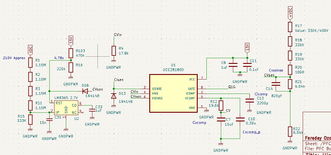

Dear Team
I need a support for Correct brownout function ic for UCC28180D PFC controller 1000W , i tried with LM8365 reset ic based on  your thread using LM8364 it seems not working .
 Schematic added and Label Cven connected to 6 th pin of UCC28180D
My problem is when i connect (PFC)gate resistor the LM8365 input pin seems as sown in the Pictures
Yellow Line Input voltage , Green line Reset pin, its continously reset.
below image without Gate resistor(PFC) seems working
Note : input sensing pin need seperate and <10nf filtering is possible , need to pass voltage dips 10ms
