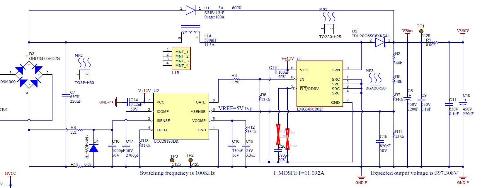

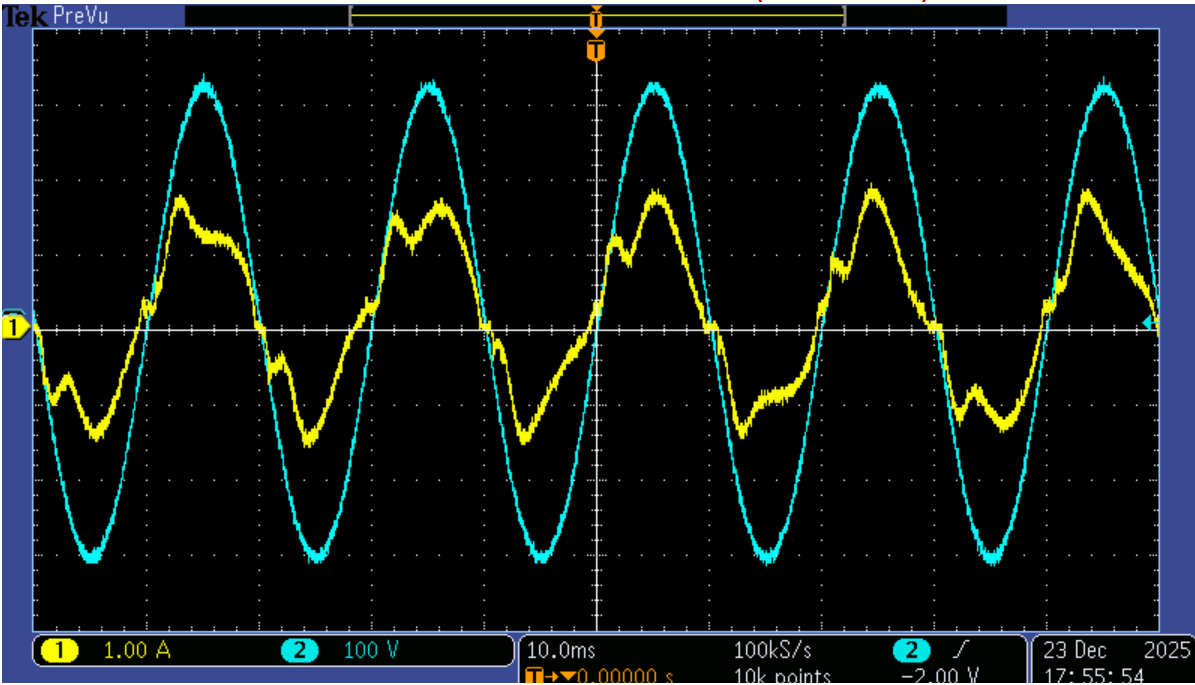

I'm design in UCC28180 in my electrosurgical tools as PFC controller. during debug, I find that the AC input current is not sine wave as I expected. my test result as below.
my schematic as below.

my calculation as below.
sluc506c--100KHz-LMG3650R025.xls
could you please guide me to make the input current to sine wave? big thanks.

  • Hi Bill,
    Can you please try to capture ICOMP, VCOMP pin voltage along with input voltage and inductor current? Try to capture the waveform similar way that you have captured the previous waveform.
    Sanchayan

  • Hi Bill,
    The waveforms look all correct to me. Can you share the inductor current, Input voltage and input current on your current set up that you have taken these waveforms?
    Sanchayan

  • Hi Bill,
    The input current waveform on the left looks correct to me. The issue that you asked earlier about the input current shape being non sinusoidal seems to be resolved. Do see any other issue with the input current shape?

  • Hi, Sanchayan
    the test condition for left and righ waveform is exactly same. just osillscope time range different. the only different is the left waveform show 1.5 period, but right waveform show 4.5 period. is this meet UCC28180's performance? thanks.

  • Hi Bill,
    In the right waveform number of samples per second is much lower than the left image which might be reason for this. The current shape looks correct to me. Are you seeing any other issue with it?
