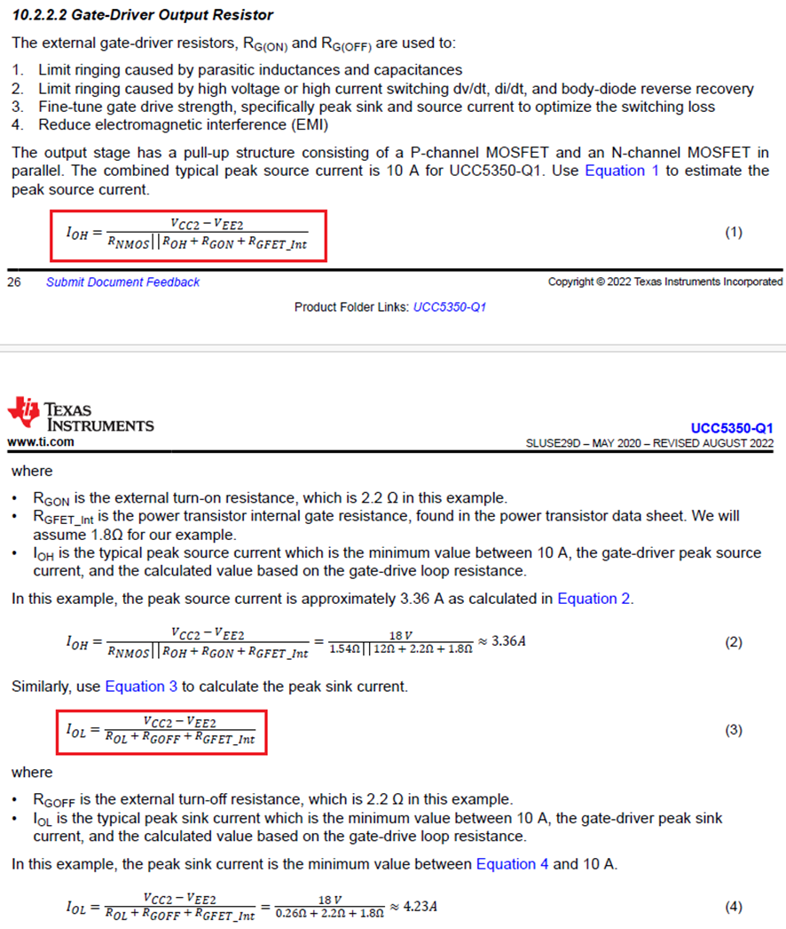

3. In the diagram below, when evaluating peak current, should the internal resistance of the MOSFETs in this dual parallel FETs configuration be divided by 2?

    3. I believe for R_GFET_Int, you would need to multiply it by 2 since there would be two gate resistances that make up the total resistance, along with two resistors each for R_GON and R_GOFF. Additionally, R_NMOS, R_OH, and R_OL would not need to be multiplied by 2, since these resistances are internal to the gate driver.
