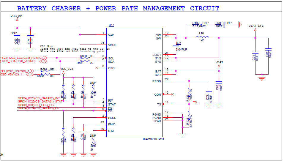

We are using BQ25601RTWR in our design (telematics product) and we are observing an ring at the output of the IC when the input supply is given(12V) which is passed through a protection circuit and a 5V buck regulator whose output is given to the battery charger IC input.
We are also using an battery of 1500mAh(4.2V) which is connected to the battery charger IC and provides power when there is no input present. and similar ringing is obsevred with the battery connected.
Is there any way in which we could make sure that the input ringing observed is not getting propogated at the output?

FYI, circuit reference.

    What you are showing is a SYS transient that occurs on startup. From the looks of the first waveform, the 12V supply has some ringing itself. My first recommendation would be to control the input turn on to avoid ringing that could be passed to the BQ25601.
    Second, there are a number of things that could be done to improve the performance of the BQ25601:
    1. Improve layout so that PMID, SYS, and BAT capacitors are as close to their pins as possible.
    2. Implement the RC snubber on the SW node you have available.
    3. Consider extra filtering such as a ferrite bead.
    Please see Section 9.3.3, it takes a few seconds to power on the input.
