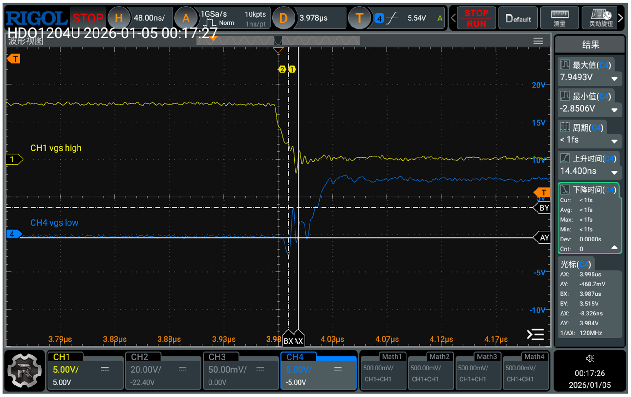

Customer is evaluating LM5146 and they saw some osillation on both high-side MOSFET VGS and low-side MOSFET VGS during the deadzone time, I am wondering:
  1. Do you see similar osillation in EVM by the same operating condtions? Vin=48V, Vout=8.5V, Iout=5A, Fsw=250kHz.
  2. To mitigate the osillation, snubber circuit is the best choice, right? Do you have another suggestion?
  3. Are there any risk for this kind of osillation?

    This could be due the way customer is probing the signal. Let's make sure we are using shortest loop method. Also incorporate pigtail probing in measurement. Kindly share schematic and layout as well.

    Just to add what Onkar mentioned. This is capacitive coupling from the SW voltage, with a subsequent resonance created by the parasitic gate loop inductance. What's helpful here is to keep the LO trace short and wide over a GND plane.

    It seems that the LO trace is too long in this case, beside the PCB layout, do you have any comments for the schematic? The attachment is their schematic.

    Connect VOUT to VCC through a diode to provide bias power to VCC. This will reduce the IC operating temperature. In terms of the gate drive, remove the series resistors and diode on the low-side gate - these just add parasitic inductance and are not recommended (see data sheet and EVM schematics). They're also not needed on the high side, as the boot cap series resistor can manage the turn on. Remove the caps around the low-side FET as well, as these just increase losses. What are the FET part numbers?
    Go ahead and complete the LM5146 quickstart calculator for this design – we can have a call to review everything if needed. Note that if Iout = 5A, we recommend a converter for this...LM70860 80V/6A for example...much easier solution.

    Target is < 10nH of parastic inductance. Take the waveform as well with the SW voltage, so we can see if it's capacitive or inductive related.
