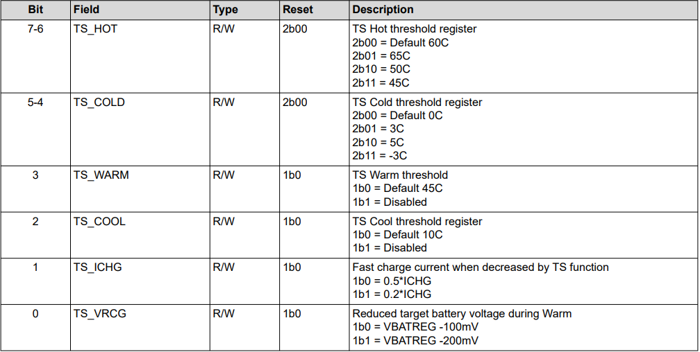

The I2C-controlled BQ2518x devices support JEITA battery temperature monitoring during charging, providing four temperature thresholds: HOT, WARM, COOL, and COLD.
The TS_HOT and TS_COLD bits select the reference voltage thresholds that are used for these ranges. These thresholds are listed in the Battery NTC Monitor section of the Electrical Characteristics table in the BQ2518x datasheet.
If the battery is HOT or COLD, charging is suspended if the TS_EN bit is 1. The CHG_DIS bit does not change when charging is suspended. Charging is automatically resumed when VTS reenters the normal battery temperature range.
If the battery is COOL, the charge current is reduced by either 1/2 or 1/5, depending on the setting of the TS_ICHG bit in REG0xB.
If the battery is WARM, the target battery regulation voltage is reduced by either 100mV or 200mV, depending on the setting of the TS_VRCG bit in REG0xB.
The WARM and COOL thresholds can each be disabled in REG0xB.
The HOT and COLD thresholds are configurable in REG0xB.
