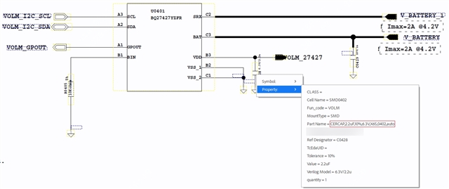

  • Q6:Hi, this is our design schematic. The capacitor parameters on the VDD are: CERCAP, 2.2uF, 10%, 6.3V, X6S, 0402, auto.
    Could you please evaluate if there are any issues or risks in our design?

  • Please attach the datasheet for this capacitor. Tentatively, it looks ok (fairly large package) but the 6.3V rating could be a problem if it's de-rated to <2.2uF at 1.8V over temperature. The only way to know is by checking with the datasheet. If the de-rating is not compatible, there will be suitable ceramic capacitors in 0402 package. It's usually a problem is 0201 package where most are significantly de-rated at 1.8V.

    Hi Dominik, the spec of 6.3V/2.2uF package(0402),please look the attachment.
    and the capacitor rating related to temperature  graph as follow:
     DC Voltage and AC Voltage Characteristic
  • The screenshot shows the data for a 0.1uF 50V rated capacitor. Do you also have this for your capacitor?
  • Hi Dominik,
    Of course, the capacitor we use is 6.3V/2.2uF,
    In Murata's spec, not every capacitor rating will be explained because 0.1uF and 2.2uF are a series of capacitors, and Murata used 0.1uF as an example. When the ratings of 2.2uF and 0.1uF are the same, we can see from the process that as the temperature changes, the maximum rating is 10%
