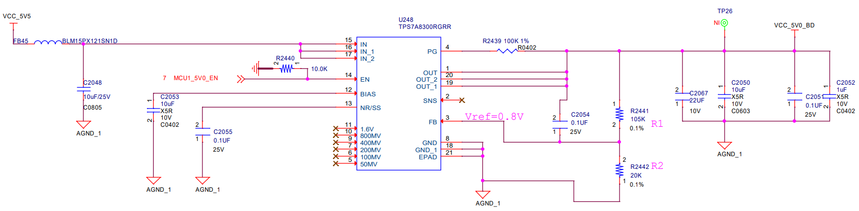

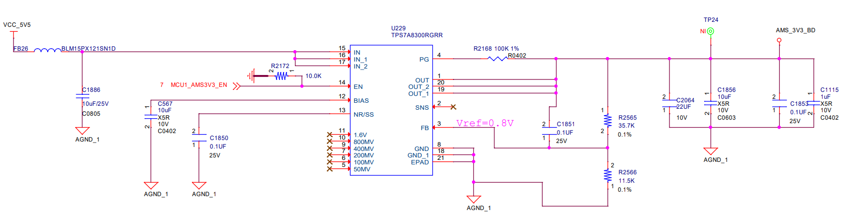

On my board, There are two TPS7A8300s which output 3.3V and 5V separately. They all work at adjustable mode through external resistor divider at FB PIN, and have the same pcb layout design. Their EN pin are connected to MCU, and also pull down with 10K resistor. After power on and before MCU drive high to EN pin, EN should be pull down and two TPS7A8300s couldn't output voltage. But the TPS7A8300 for 3.3V output 2V at this time slot, then output 3.3V after EN is drived high by MCU. The TPS7A8300 for 5V is work normally which could ramp up from 0V to 5V directly after EN is drived high by MCU . For excluding the impact of MCU, I use anohter board which don't programm firmware of MCU yet. That means all PIN of MCU will be in the floating state and EN PIN should always be pull down.  After power on, I get fixed 2V by using multimeter for 3.3V TPS7A8300.
Why this TPS7A8300 on my board have 2V output during EN pin pull down? Could you please verify this problem on your demo board?

                                                     Figure1.  TPS7A8300 for 3.3V
                                                                Figure2.  TPS7A8300 for 5V

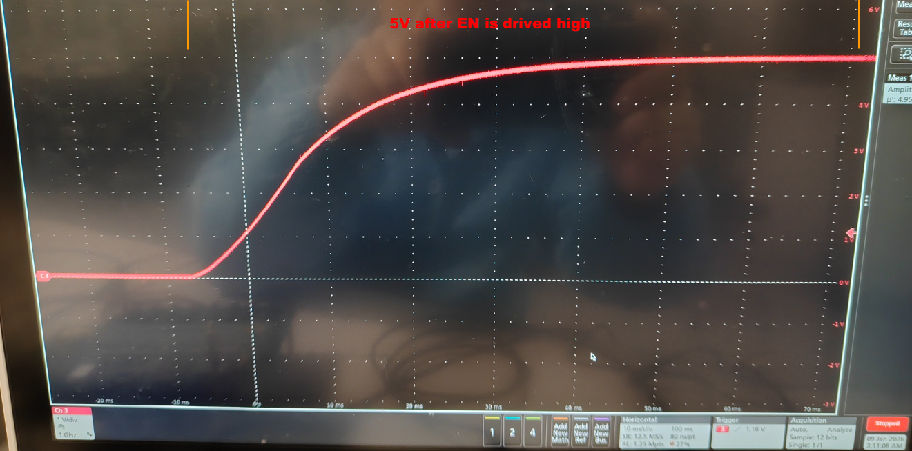

    Please see below scope shot with VIN 5V5, VEN and VOUT 3.3V. You can see that VOUT source 2V before EN is driven high.
    I also get a strange slot marked orange which VIN is behind VOUT. It violate causality
    Is there other source inserting into 3V3 rail before VIN 5V5 start up?

  • Hey Shen,
    It appears another source is pulling up the output. Is there anyway you can isolate the LDO from the rest of the system?

    But I have another question as below figure shown:
    when I remove bead FB27 to cut off the input power to TPS7A8300, 2V on the VOUT 3.3V from reference source(2.5V) will flow to input of LDO reversely?
    I can measure this fixed 1.6V on the input of LDO. This kind of reverse flow come through the body diode of NMOS in the LDO?
    Thanks in advance!

  • Hey Shen,
    The output of the LDO should not be more than 0.3V above VIN as per the absolute maximum ratings section of the datasheet
    Yes, the 1.6V is caused by reverse current across the body diode of the pass fet.
