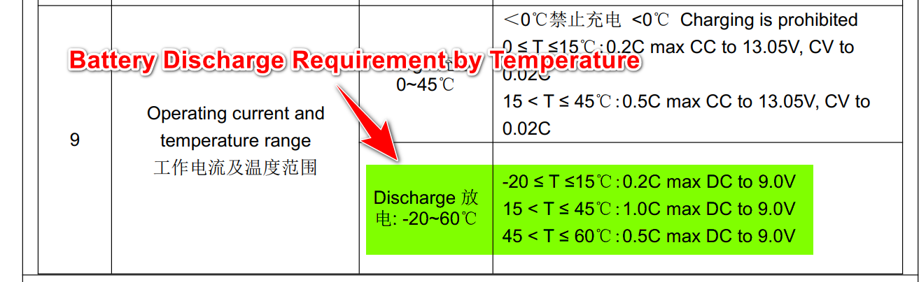

My battery has the follow discharging requirement by different battery temperature, Can I use EC to write to BQ24780S  Discharge Current Register 0x39 to limit the maximum discharge current by detecting different temperature from battery pack to achieve this discharging current vs. temperature goal?
  • Hello Zhang,
    You can use the EC to write to the device, but you will need some external circuit, like a Fuel Gauge to measure the battery temperature and then feed that information to the EC to determine what charge current to write
    Christian.
