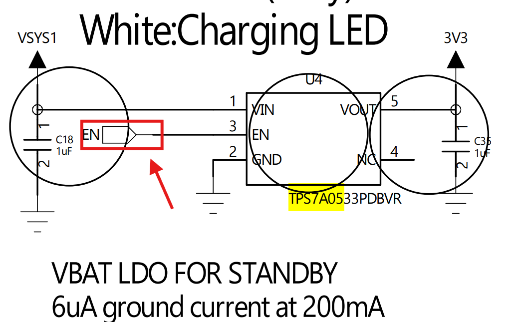

Part Number: TPS7A05
Hi ti team,
Could you please advise whether the EN PIN of the TPS7A05 has an internal pull-up resistor? Thanks!
Hey,
No, the EN pin does not have an internal pull up resistor.
