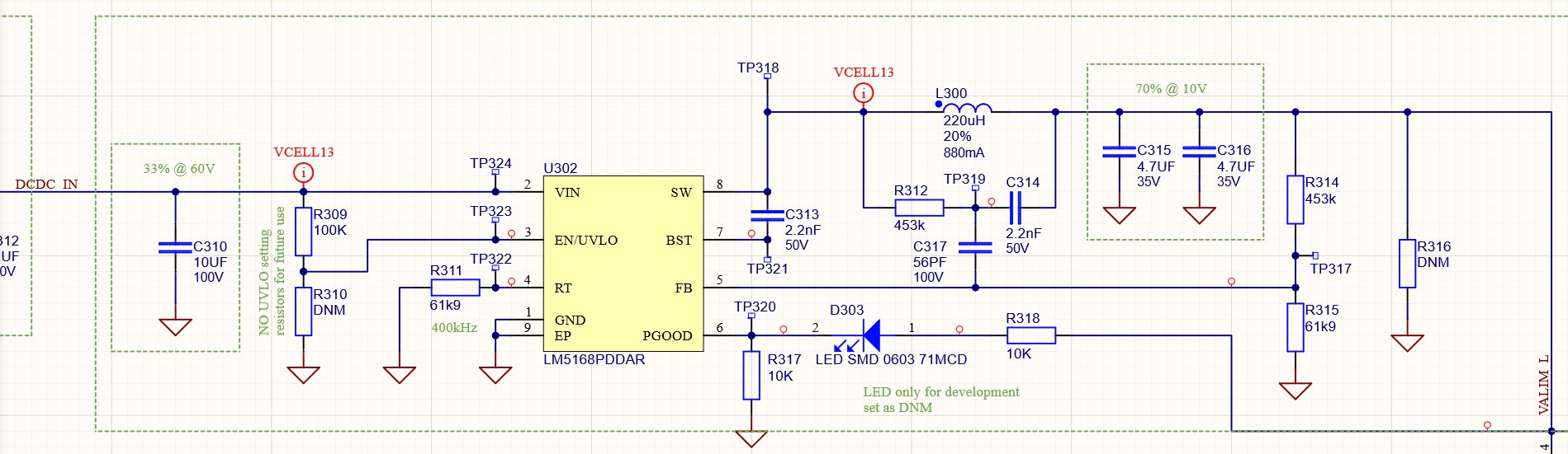

Hi
Due to problems with sleep functionality of LM5168P I'm asking for rewiev of board design.
Problems with converter are described in different thread:
https://e2e.ti.com/support/power-management-group/power-management/f/power-management-forum/1605639/lm5168-q1-lm5168p---problem-with-sleep-on-low-loads/6197290
Actually, project has 3 slightly different boards with 3 very similar LM5168P layouts - problems are the same for all of them. Schematic is the same for all DCDC's.
Unfortulatelly, I cannot send pcb files for that boards because they contain design that cannot be shared.
Because of that I'm sending jpg files of each layer of each design. If that's not enough, I will cut part of board to share it...
note: DCDC converter doesn't have optional input EMI filter - there is option for that on PCB but not mounted.
layout0.zip
layout1.zip
layout2.zip

    I have gone through layout_0 and here are the comments. SW node must be far from FB routing otherwise it can couple switching noise. As you see moving the board physically changes the waveform and expected behavior is visible, I think it could be due to layout issues.
    1. the SW node polygon is very near to FB pins and routing. Must lift the inductor upwards to keep FB routing far from SW node.
    2. The connection from TP319 to C317 is going directly below the inductor. Must improve this wiring as per EVM user guide/datasheet *LM5168PEVM EVM User's Guide page -10.

    Schematic change from previous thread didn't work - I wrote this in response to that suggestion. Changing injected ripple doesn't resolve issue.
    All layouts are actual, we have 3 versions of boards with 3 very similar layouts of DCDC converters modified to fit on different PCB's, but your suggestions in terms of inductor and feedback lines placement are appropriate for all of them and I can agree with them.
    It must be taken into account that feedback is shielded with 2 layers of copper and inductor is in shielded version.
    I've tested it:
    - pulled inductor up so it's further away from feedback
    - original switching node is now cut off and connected to ground - so feedback lines cannot be affected by inductor now
    It didn't help, DCDC behavior is still the same - sleep doesn't work at lower voltages. DCDC overall stability is working ok, switching looks ok.
    Board looks awful because it was covered by isolation layer of plastic - it's hard to remove completely.
    You must take into account that we have quite a lot of that PCB's, and around 93% of them are working without issues. Now I'm trying to figure out what's wrong with rest of them. Also, on the beginning we assembled 9 boards for tests (3 of each layout) and all of them were working fine.
    One more thing that came out - touching frequency setting resistor Rt (R311) or net that it's connected to (pin-4) also causes DCDC to work ok and brings back sleep function. (touched with needle connected to human body being far away from feedback components). So it makes the same effect that touching feedback - it's the same on modified and not modified boards.

    1. Even if you move the inductor up but still the TP319 to C317 track is crossing SW node cu so it is prone to SW node noise I think.
    2. I think it could be due to soldering issues also, may be the ground is not properly connected. This makes sense to me as you clearly mentioned some of the boards are working fine and some are not and pressing down the components helps.

    1. I cut off inductor pad and all switching area and connected it to ground, you can see soldered area on the photo, so it shouldn't affect feedback that way.
    2. Also thought about it, but after removing DCDC converter and placing it again nothing changes, tried it on 2 or 3 PCB's. While removing I can say that they are soldered perfectly and thermal pad is fully connected to PCB.
    Replacing IC with different one solves the issue, looking like IC's are the problem here.

    As the ground layer also goes below the inductor (even at the modified setup)
    Due to the eddy current in the ground layer, the inductor value decreases and the loss increase with set-off effect from the line of magnetic force. Signal line other than ground also has the possibility of propagating switching noise caused by eddy current. It is better to avoid wiring directly under inductor. If wiring is unavoidable, I would recommend using shielded inductor. What kind of inductor are you using?
    2. As touching external components with needle resolves the issue, the issue very likely due to layout or improper soldering. It seems to be some isue with ground connection as explained above.
    I would recommend testing the IC in TI EVM and check if it resolved.
  • 1. Ok, I get this point now. Inductor is shielded, part number is: IFSC3232DBER221M02
    2. Also thought about buying LM5168PEVM and modifying it with our parts, probably will proceed with that

    I have an update - bought LM5168PEVM eval board and reconfigured it to be similar as our project, components replaced:
    R8 - 62k
    R9 - 62k
    C4 - 2n2
    L1 - 220uH (IFSC3232DBER221M02)
    U1 - DCDC converter taken from problematic PCB
    rest of components stayed without changes
    Problem with sleep still occurs in the same way, once again touching feedback nodes solves issue.
    In my opinion it confirms that layout is not the issue since the problem is identical on TI eval board...

    As I wrote at the beginning, replacing IC solves the issue, and only about 7% of assembled PCBs have this problem
