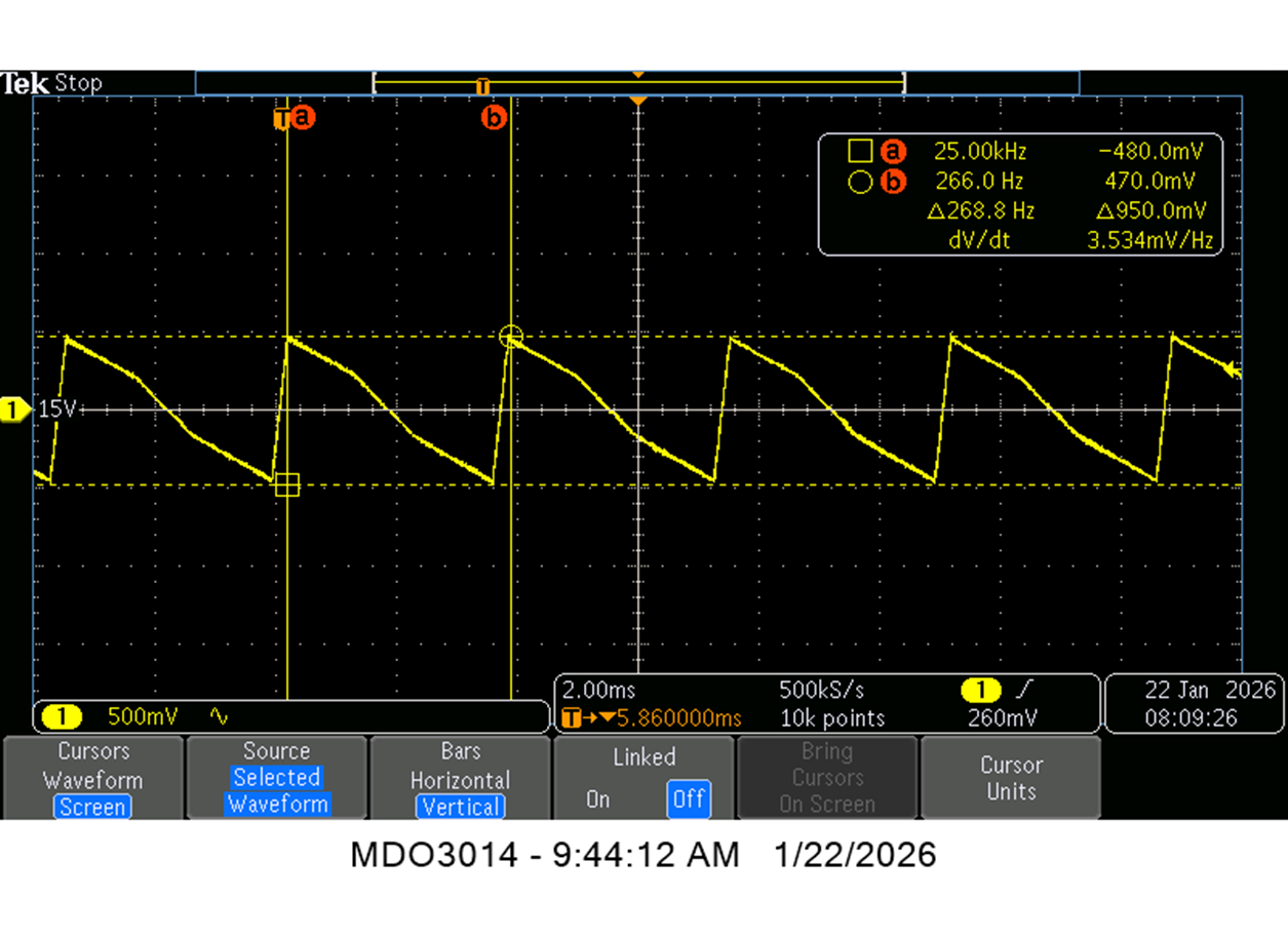

  1. Vin = 320VDC, Output Load1(15V) = ~330mA and Output Load2(20V_ISO) = 80mA . Ripple of 1.182V is observed on 15V Output.
  2. Vin = 180VDC, Output Load1(15V) = ~330mA and Output Load2(20V_ISO) = 80mA . Ripple of 1V is observed on 15V Output.
  3. Vin = 180VDC, Output Load1(15V) = ~50mA and Output Load2(20V_ISO) = 80mA . Ripple of 0.782V is observed on 15V Output.
  4. Vin = 320VDC, Output Load1(15V) = ~50mA and Output Load2(20V_ISO) = 80mA . Ripple of 1.022V is observed on 15V Output.
Ripple frequency is varying from 200Hz to 2kHz in the above conditions.

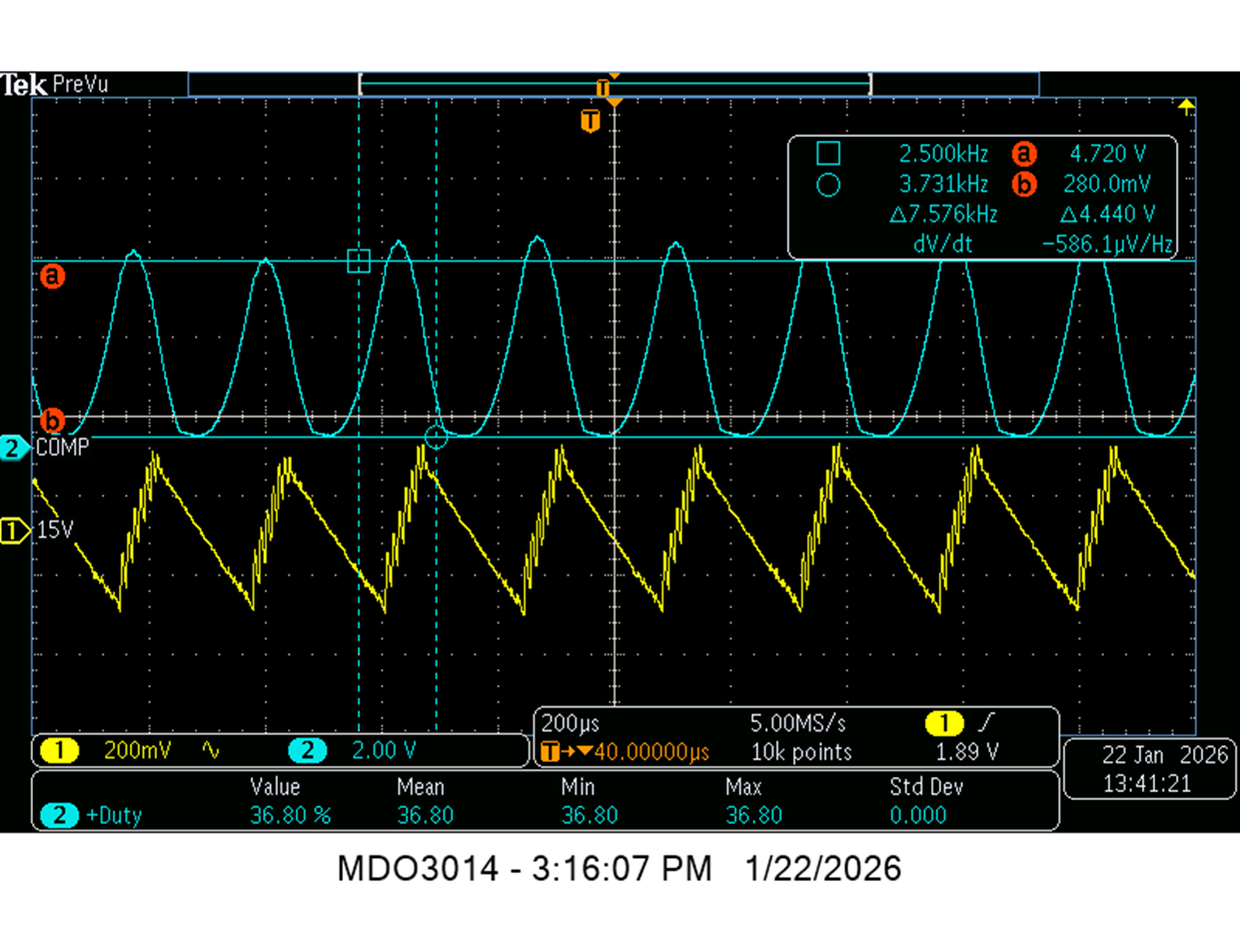

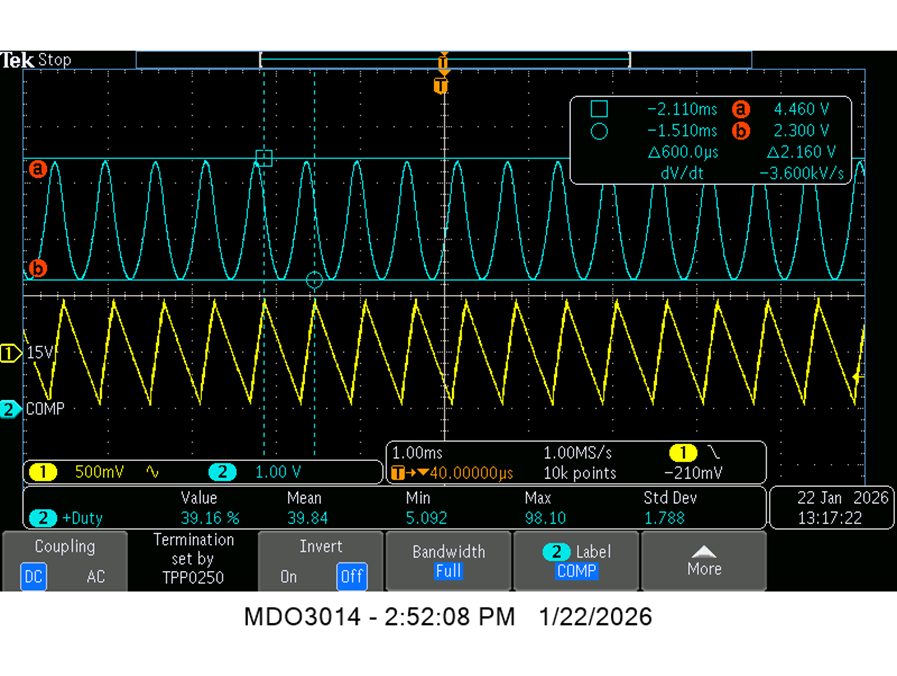

3. Later , we modified the compensation circuit connected to FB and COMP Pin, by replacing C72(Ccomp) to 2.2nF( to reduce ripple). No imprvement observed there as well. Also we are observing COMP voltage varying from 4.46V to 2.3V in this condition. Why is it so?
4. Since no improvement observed in any of the conditions, we removed both C72(Ccomp) and R53 (Rcomp) retaining only C53.  At this condition , Vout ripple reduced to 500mV but not clean. Also Comp voltage varies from 4.720V to 280mV.

  • Hi Asha,
    There is some immediately apparent instability at the COMP pin, which corresponds to the same fluctuation in output voltage that you are seeing.

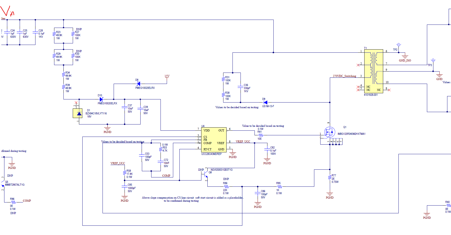

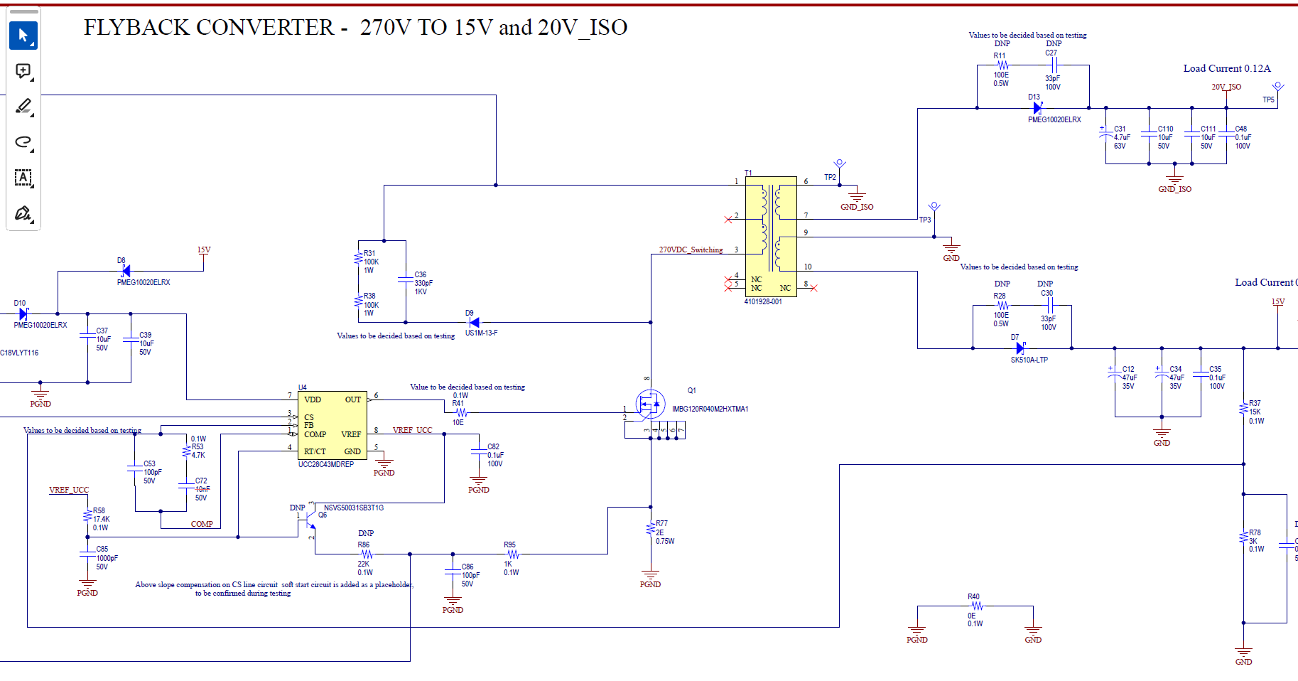

    What is the value of the current sense resistor that you are using? Could you additionally share your transformer turns ratio?
    John
  • Hello Gomez,
    We are using 2ohm Current sense resistor and Turns ratio is 36(Primary):3(Output1- Sec1):4(Output2 - Sec2) which is 36:3:4.
  • I have attached the schematic as well in the previous reply.
  • Hi Asha,
    Thanks, what is the magentizing inductance of the transformer and what is the value of the capacitor in parallel with the bottom Vout voltage divider resistor?
  • Hi Asha,
    Your current sense resistor value is likely way too large at 2ohm. It could be causing instability in the control loop.
    Please try changing this resistor to about 500mohm, then re-test, and report back.

  • Hello Gomez,
    In order to limit the primary current to <0.4A , we have set the current sense resistor to 2ohm. 500mohm would set the overcurrent limit to higher value.
  • Hi Asha,
    The voltage threshold for detecting an overcurrent event is 1V. If you wanted to set the overcurrent protection threshold at 400mA, you would have to set your current sense resistor to 1V/400mA = 2.5ohms.
    However, this is besides the point that I am trying to make. In order to understand why you are seeing significant oscillations at the COMP pin (which are causing oscillations in your output voltage) we need to isolate the root cause of the issue. For this, I am recommending to try a smaller current sense resistor value, to observe if there is any change.
    Please try the 500mohm CS resistor such that we can alter the characteristic of the entire feedback loop and observe any changes. Please collect the same COMP and output voltage scope shot after you have made this change.
