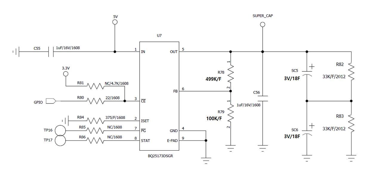

Part Number: BQ25173
Vin: 5V
Vout: 4.99V
Supercap: 3V@18F 2S
Charging Current: 800mA
Questions
1. When charging at 5V, what is the final voltage when the Supercap is fully charged?
2. Please check if there are any issues with the circuit.

Hello
Based on the setting of FB pin and R78/R79 the final charge voltage will be 4.8V.
Note that as Vin-Vout decreased the output current will also decrease. See Tabel 6-6 Page 8 of Datasheet.
The balance resistors R82 and R83 look a little low in value, 330k would be a typical value.
Rest of circuit looks good.
1. When the supercapacitor starts charging from 0 V, could the current not reach 800 mA due to overheating of the BQ25173?
- It's currently connected via wiring, not mounted on the PCB.
2. When Vin is 5.0 V, can I charge R78/R79 to 4.979 V by setting the resistance values to 210 kΩ and 40.2 kΩ?
Hello
The BQ25173 has thermal regulation that will prevent overheating by reducing output current. With a large voltage drop across the device, Vout = 0V the power dissipation will be high and unit enters thermal regulation.
This is correct setting for 4.979V. But with 5V input the Vin-Vout will be near 0V and unit will enter sleep mode. The first resistor setting for 4.8V is a better configuration.
