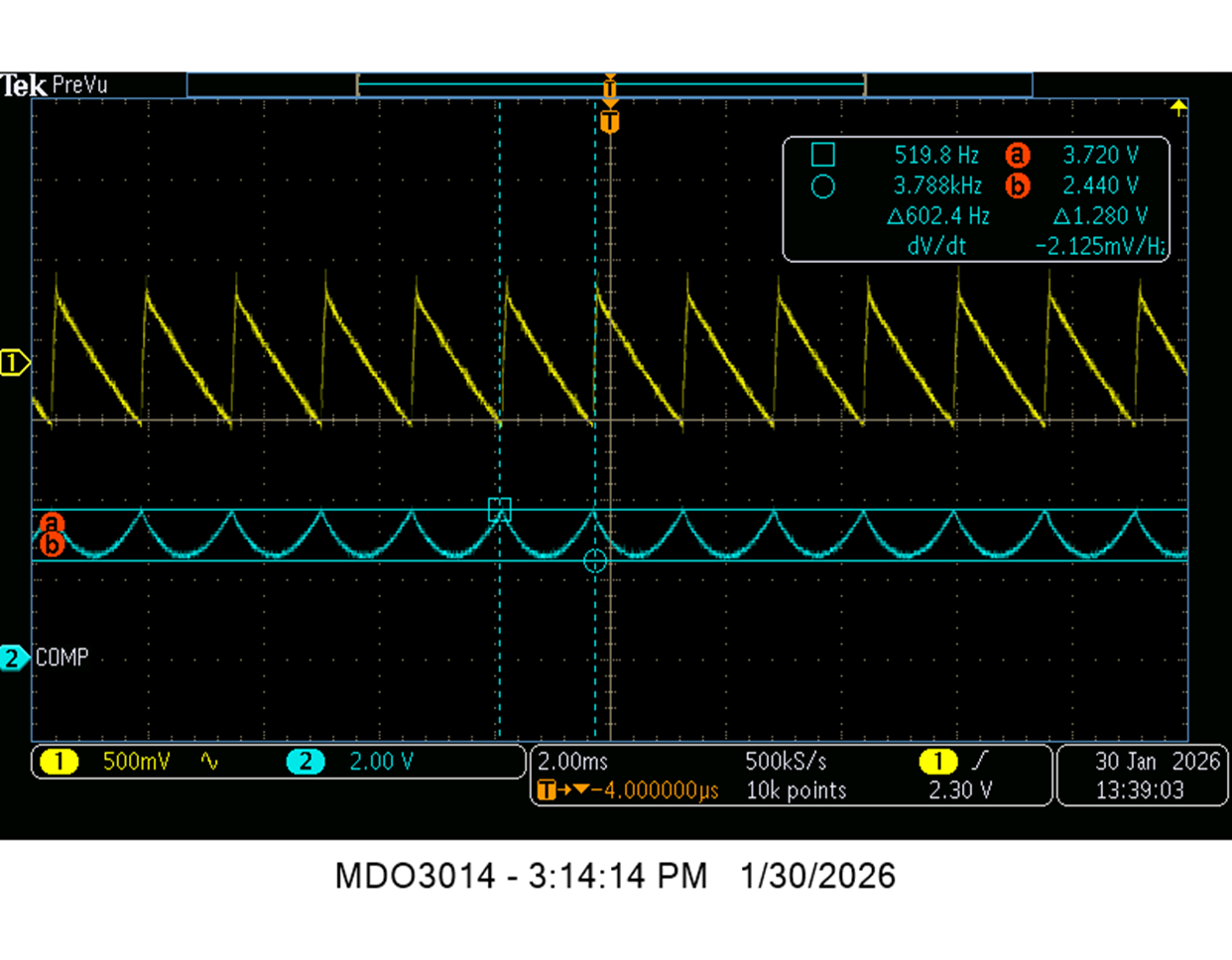

  1. With previous sense resistor 2E,
With load of 148R ie ~100mA on 15V Output, Observed 15V Ripple voltage(yellow waveform) is 800mV pk-pk and COMP voltage is varying from 2.44V to 3.72V.

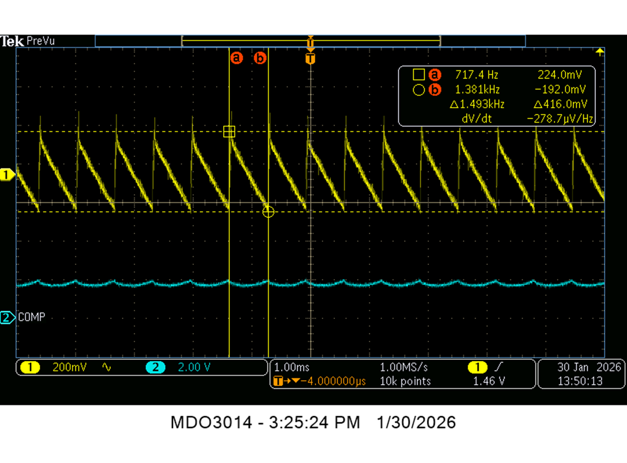

2. With updated  sense resistor 600mohm,
With load of 148R ie ~100mA on 15V Output, Observed 15V Ripple voltage(yellow waveform) is 416mV pk-pk and COMP voltage is varying from 1.56V to 2.04V.

  • Hi Asha,
    It looks like decreasing the current sense resistor is definitely helping with stability at the COMP pin, which is reducing your output voltage ripple.
    Based on this observed result, I would guess that your feedback loop has a very low phase margin which is making the system unstable. To address this, the gain of the feedback  loop can be reduced by a bit, such that phase margin is improved. We actually did this when we reduced the gain of the feedback loop by reducing the value of the current sense resistor.
    To further reduce the gain, you can decrease the value of R53. Right now, it is set to 4.7k - you can try going down to about 1k. You can also increase the value of C53 to about 10uF. Please try these changes one at a time and observe the result.
