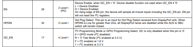

Q1: When using I2C control, can we left open 11pin(EQ0), 14pin(EQ1), 2pin(DPEQ1) and 3pin(SSEQ1)? or do we need to pull-down or -up to somewhere? If possible open is preferred for design.
Q2: Are we able to directly tie EN(pin-29) to 3.3V without pull-up resistor? TUSB1064-Q1 D/S mentions it requires 10k or 50kohm resistor. PoV of replacement from competitor, no resistor is preferred as well as Q1.
    Yes leaving these EQ control pins floating is OK if I2C mode will be used.
    TUSB1064:
    Its best to use a resistor PUP to limit the current pulled into EN. This pin has an internal PDOWN.
