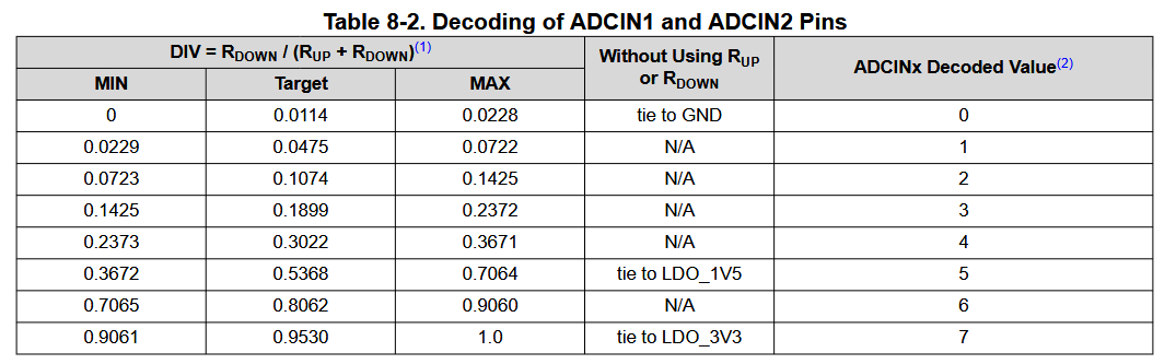

Issue: The controller fails to load the configuration from the external Flash memory when booting in Dead Battery Mode.
Current Setup & Observations:
  • Hardware: My schematic is a direct copy of the USB-PD-CHG-EVM-01 reference design.
  • Boot Pins: Both ADCIN1 and ADCIN2 are tied to GND (i've tried it), which should theoretically set the device to boot from the external Flash when is dead battery mode cf: SafeMode.
  • Power: The issue occurs specifically when the system is powered via VBUS (Dead Battery condition).
  • Behavior: The device does not seem to apply the configuration from eeprom, resulting in a failure to negotiate the expected Power Delivery profile (always giving 5V when not supposed to, the IC charger that follow it isn't configured either due to the flash config nto being used properly).

    In the schematic it shows that the ADCINs are connected to LDO_1V5.  Please be sure that when you grounded the ADCIN pins the LDO_1V5 is not impaired.   However, if there was an issue with LDO_1V5 you would see it in both the deadbattery and non-deadbattery states.
    Can you confirm that LDO_3V3 is correct when the USB is first connected (LDO_3V3 is derived from VBUS in deadbattery mode)?
    Can you also confirm what is happening on the I2C lines?  The BQ, EEPROM, and PD are all connected to this bus but in the safeMode only the EEPROM and PD are powered.  Do you know if the BQ is low impedance and thus preventing the I2C comms?

    The VIH minimum for both devices is 1.3V, so I suspect the communication is not working.  In the original design the dead-battery condition is always enable sink instead of safe mode.  Have you tried with always enable on to determine if applying VBUS/PPHV to the BQ device resolves the issue with loading from dead battery?
    Alternatively, can you disconnect the I2C from the BQ device and see if the I2C lines go to LDO_3V3?
